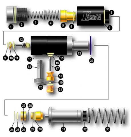

    I realize this is an RT Pro valve-image but I couldn't find an image of an RT Classic valve and they are similar enough for my purposes:

    So far I have changed out the following with fresh o rings from a new AGD parts kit or new parts from AGD:
    -Power tube tip o ring
    -Power tube o ring (below spacer)
    -bumper
    -# 16 (no #15 in rt classic valve)
    -# 19
    -# 20
    -# 11
    -# 9
    -# 7
    -# 2
    -New high pressure piston
    -New sear
    -Both O rings and washer thing on reg pin assembly
    Did NOT change springs in the back of valve.
