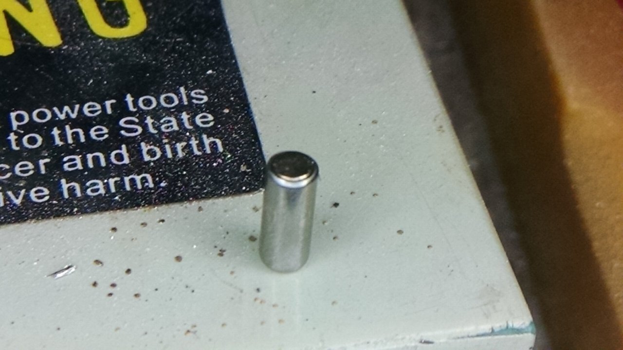

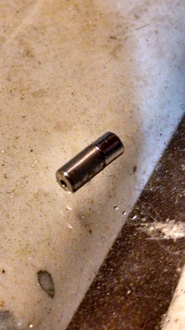

    The first attempt was a little difficult to assemble and keep aligned. This is a 1/8" diameter by 1/8" long magnet.
    The second attempt slid itself together. The ULT stainless is mildly magnetic. This is a 1/10" diameter by 1/10" long magnet.

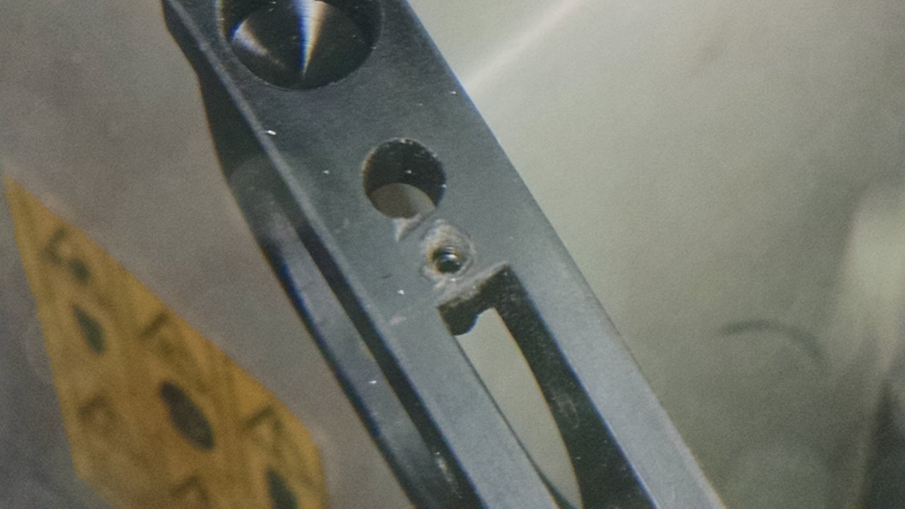

    Added a trigger over-travel stop;

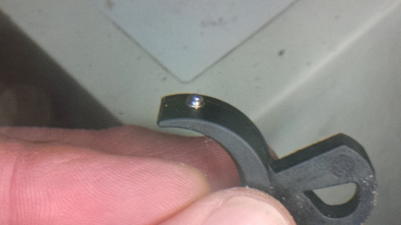

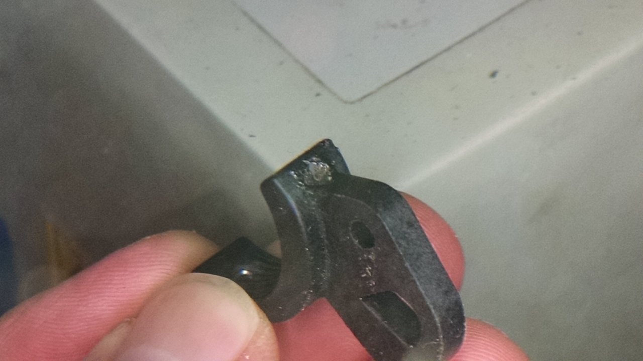

    Added a magnet in the trigger to give it a little breaking feel. It is almost too small, it is 1/16" diameter by 1/8" long (iirc). That is epoxy showing.

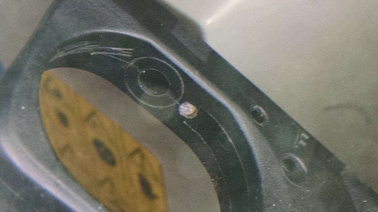

    and a set screw target in the frame for the magnet. Top,

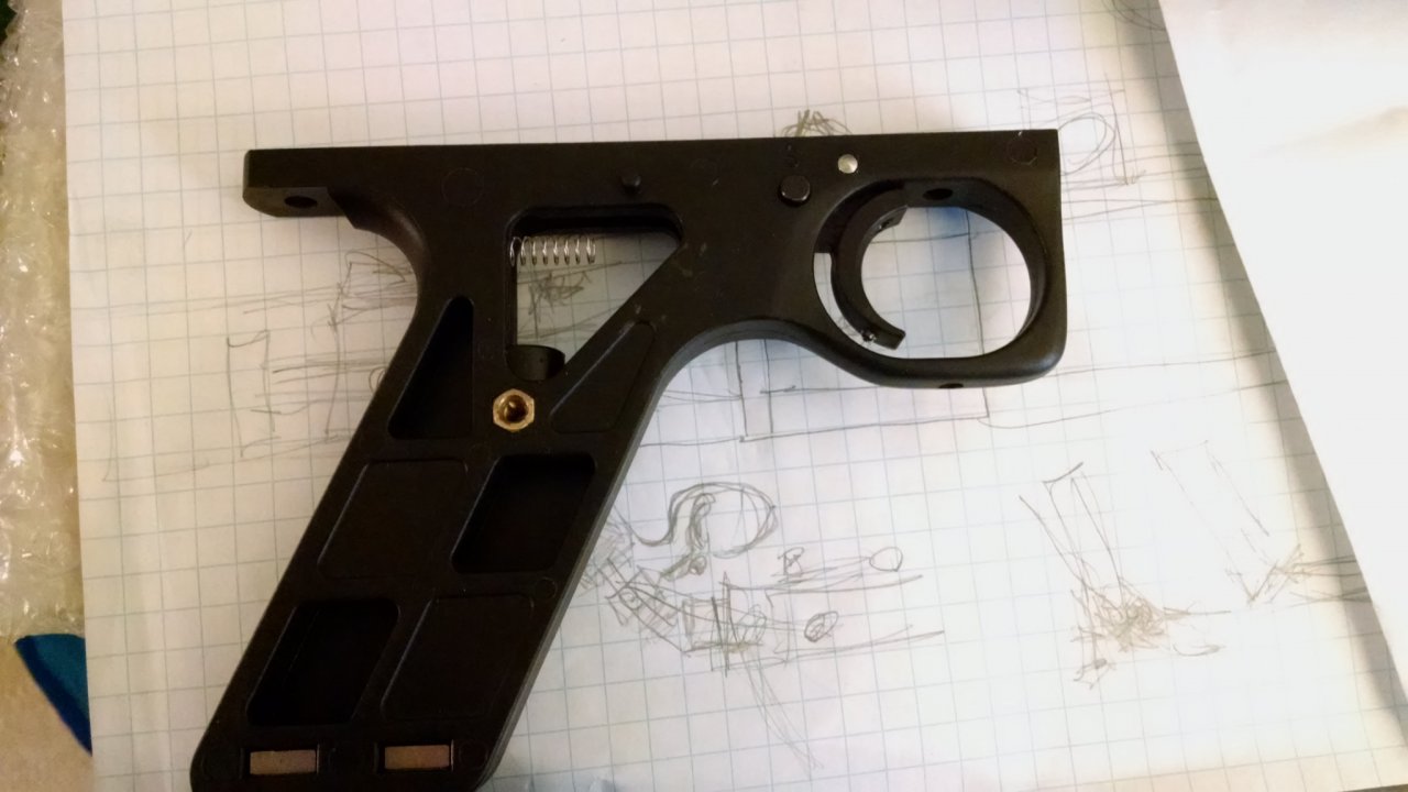

    and bottom view. The target ended up getting adjusted as close as possible to the magnet. It has a "break", but it is very light.
    added a return spring for the sear. This spring got trimmed by at least half. It is in a hole I dremeled into the very convenient pocket in the back of the frame, to keep it steady.
    I'll have to see how the magnet wears. I polished the sear face under the pin and put a layer of grease on it. It doesn't have a huge grip compared to the nickel plating of the magnet, so I have hope on wear.

                Thanks, I have to say it looks like a #4 (40)... I try to stay at #6 (32) or larger. I batted both around at the time, but I found that nice stainless set screw among my spares and settled it that way. It's not a high load, and it's easy to tap, so #4 or #6 will work. Set it where the trigger trips reliably before you put any additional pressure on the trigger (without taking up hinge slack), and you won't notice it is there (except when you go to take the valve out). If you just take one pass with the tap, the CF stays pretty grippy on the screw, and the screw stays in place well.
                I think it only stops about 0.04" of travel, but that is unused recovery travel on the on/off pin which can go to recharge time instead. If there is time in it, there must be money. Tuning ULTs with 0.005" shims and then stuffing the on/off pin through the o-ring an extra 0.030" to 0.050" seems like a waste to me.
                The other way to do it is to shorten (turn in) the trigger rod, which is not very convenient to adjust. Then you could use a pre-travel adjustment screw to get back to the "credit card gap", or just live with the dangle. The ULT pull by itself just feels like seal and sear friction. Without the RT bump, you don't get much of a cue to tell your finger to go the other way. A little break at the start and a bump in the back made it easy for me to pick up on the trigger action.
