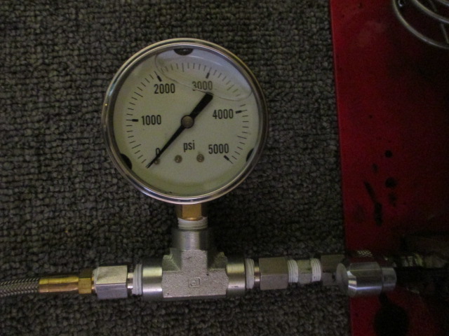

                      That is more so that the actual output differs from the output on paper. If you want, test the output on a reg tester but do not use just any gauge. Most gauges for paintball are off or inaccurate, by design. It could +/- of 1% or 20%. And the same goes for the regs too. Not all springs, bellville washers or whatever are equal. Remember, you are paying for the cheapest parts. Those setups are a general guide to how it should be,not what it is. Real world testing should always be done with a certified, tested gauge that is +/-1% or less.
                      • Mondoatx
                        • Sep 2016
                        • 206
                        Nobody,
                        Thanks for the insight. I have checked the output on all my bottles... but they have been standard paintball micro gauge style... so I guess this begs the question... how does one ensure they are using a certified, tested gauge that is +/- 1%? Where would one acquire a gauge like this?
                        Thanks man.
                        M
                          • 8216
                          Not exactly cheap> https://www.mcmaster.com/#liquid-fil...auges/=17cwo2p
                            Never said they were, but when you are testing regs, knowing you have something that says 200psi into the gun, saves a lot of expensive & hard to get noids.
                            But yes, they aren't for the common tool kit, but if you know that you would use these i a lot of applications were accuracy is paramont, then it is an investment for the better
                              • 8216
                              Wasn't a dig, just a fact.
                              Here's mine.
