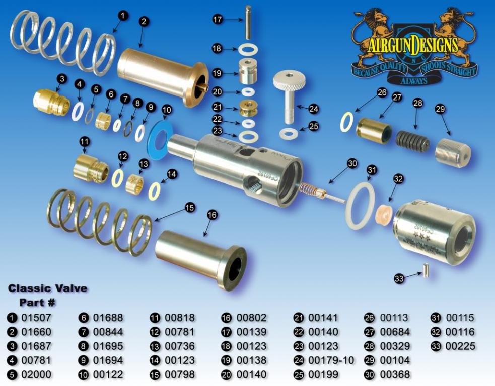

    Sounds more like a body o-ring (#31 in the pic below). Even if it's new, sometimes it just doesn't fit right, especially with aftermarket regulators. Or it's possible that some gunk is stuck underneath, causing it to not seal correctly.
    I would remove the body o-ring, clean underneath really well, oil it up, and try again. If the leak persists, you might need a new o-ring. You can order one from AGD, or just visit your local hardware store. I bet they have something that will work. They probably won't have Teflon o-rings, but the normal buna ones will work fine there, since there's no moving parts. It's just a static seal.
    But it's definitely not the reg seat. Worn out reg seats cause leaking on/off assemblies, velocity spikes, and double-firings. You can literally feel the difference in the trigger when firing. If it's still shooting the way it should (except for the leak), then your problem is elsewhere.
