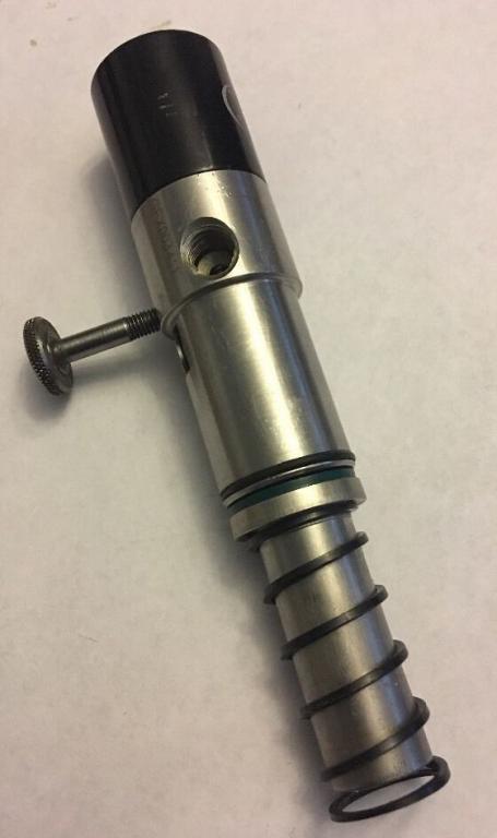

valve o ring?
  • smallerfreeze
    Bury me with my mag
    • Apr 2017
    • 241
    valve o ring?
ID:	2196306 i have seen another with the o ring on it like this... its a micromag valve.. anyone care to drop some knowledge on me please?
    Matthew 10:34
  • nak81783
    • Nov 2001
    • 782
    Hard to tell with the picture resolution, but it's possibly a poor attempt to seal the power tube / dump chamber, which is a threaded attachment with an oring. That looks like the wrong oring.
    Last of the Salzburg Clan
    • blackdeath1k
      • 2436
      Force all dump chamber air to go forward?
        powertube tip was opened up and the guy broke the original oring and replaced it with a normal one instead of the correct one.
        • smallerfreeze
          Bury me with my mag
          • Apr 2017
          • 241
          do u think it would be safe.. or should i seek out a correct one
          Matthew 10:34
          • smallerfreeze
            Bury me with my mag
            • Apr 2017
            • 241
            can you click the image to enlarge it?
            Matthew 10:34
              yes.
              makes me wonder if he cut to much when the stock one broke or wouldnt seal.
              • smallerfreeze
                Bury me with my mag
                • Apr 2017
                • 241
                yes.
                if it had been sitting for a decade, could the correct one just have gone bad and crispy?
                Matthew 10:34
                  • 8248
                  Pull the tip off and and inspect for damage, if the original oring groove is intact install the correct oring. Contact KKM for the correct oring.
                  • smallerfreeze
                    Bury me with my mag
                    • Apr 2017
                    • 241
                    awesome, thanks.. do you know the exact details of what should be the correct one??? sorry for the knowledge robbery
                    Matthew 10:34
                      • 8248
                      I sold my powertube orings to KKM so he does have the correct replacement.
                      The classic valve powertube tips have to be cut off one way or another (but they are also threaded) so it could be someone screwed up, only way to know is to inspect it. That said, pull the tip off and post some UP CLOSE pictures and we'll have a look.
                      • smallerfreeze
                        Bury me with my mag
                        • Apr 2017
                        • 241
                        stellar... its on the truck headed to mi casa ... ill post pics
                        Matthew 10:34
                          • 8648
                          Looks like a diamond labs back half too...too much going on with this one. I call JUNK! Another one for the Lagoon!
                          • smallerfreeze
                            Bury me with my mag
                            • Apr 2017
                            • 241
                            if it works im happy with it.. this one is getting aired up
                            Matthew 10:34
                              • 8248
                              I would pull the powertube off and inspect it before I put air through it.
