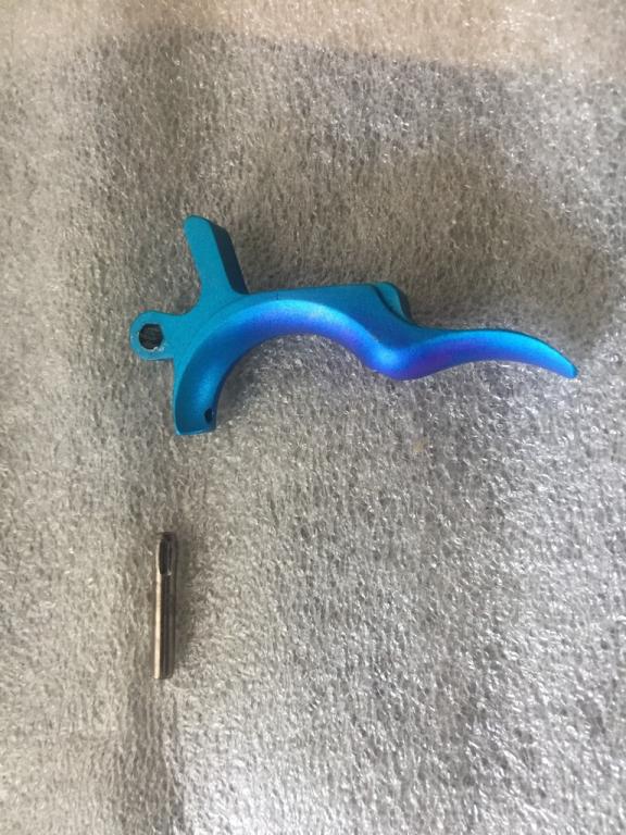

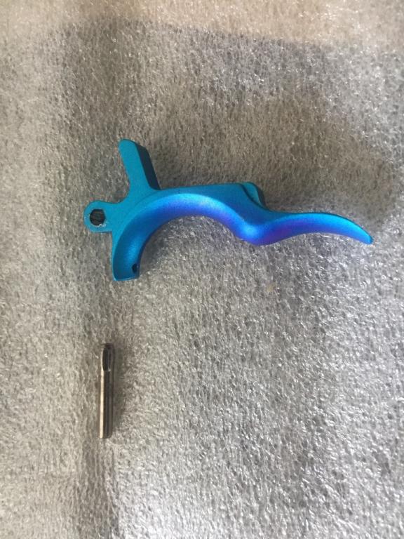

      It is the same pin that came out of the frame and is not smooth. It appears the same as that shown in the manual I found online and in the AGD store under emag trigger pin.
        • 8240
        Can you post a picture of the pin and trigger?
        • lifeincolorado
          • Oct 2014
          • 47
          The flange side of the pin doesn't actually fit through the trigger without... persuasion, but it fits smoothly through the frame where I assume it is supposed to wedge. Does not seem to matter what direction I put the pin in.

            The pin is supposed to go in from the left side of the frame. Knurled side of the pin to the left.

              • 8240
              Originally posted by lifeincolorado
              The flange side of the pin doesn't actually fit through the trigger without... persuasion.
              The knurled end of the pin is not suppose to go through the trigger, what would be the point??
              Looks like you damaged the trigger driving the pin through.

                  Yes its been re-anodized. And I realized my mistake quickly with the trigger and knurled end. its just a small bit of cosmetic damage to that side of the trigger. the pin still wont go through with out a hammer (I wont be doing that). I did try going in form the left with the knurled side to the left to start with as this was the info i found online. I checked and double checked before trying and it just slid all the way through with barely any resistance.

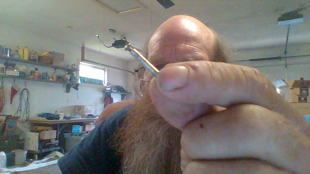

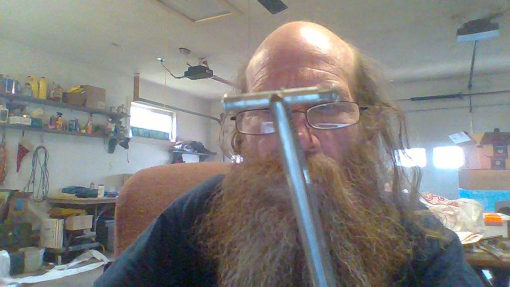

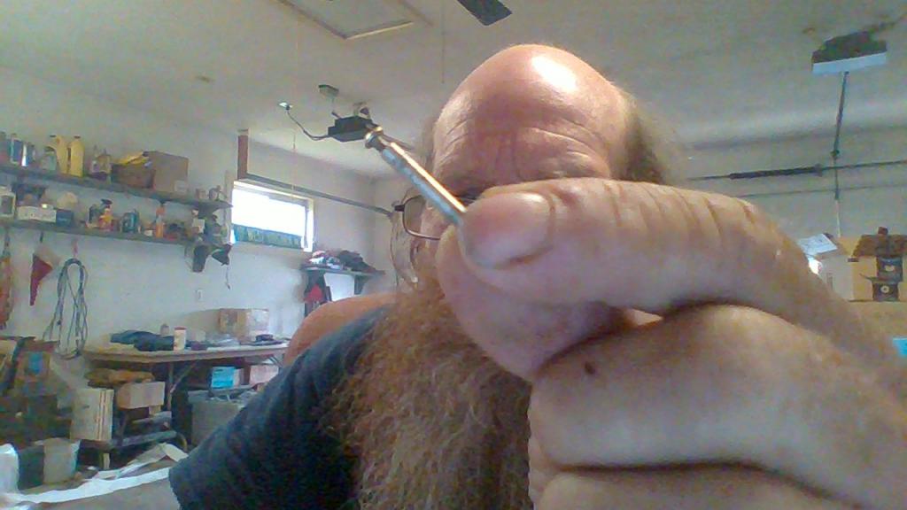

ID:	2185382Click image for larger version
                      Quite a few years back a fellow made some of these ,, it's a trigger pin with allen head screws on both sides ,,, I don't think he made very many of them ,,, if ya can find one this would solve your problem
