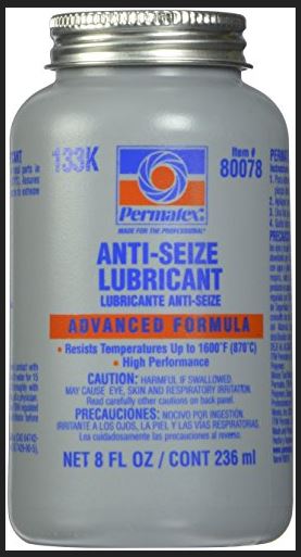

                • 8240
                It's always a good idea to use anti seize on the screws you dont remove often, it would be fine on the barrel threads too.
Name:	anti sieze.JPG
                • athomas
                  Of course it works-its AGD
                  • 8039
