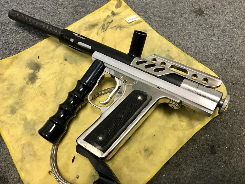

    Hey everyone,
    New to the forum here. Played a lot back in the mid 90's-early 2000's and finally getting some free time to get back out on the field. My 3rd Marker I owned (after a Scorpion and a Piranha) was a Minimag, which I recently bought back from an old friend. He did not take great care of it. Spray painted the rail/sight rail which I was able to strip and looks alright again. Owned cockers, angels, timmys, impulses, shockers since that time but found myself always wanting my mag back. What a great time to have it back with all of the awesome new (to me) stuff out there
    Anyways, I have a few parts on the way and some question about them. First up is a Y frame I have inbound. Will I need anything different (rail, sear, etc) to install and work correctly, or is it just plug and play?
    Also have a lukes angled foregrip inbound. Will it work with a stock MM rail?
    Ordering an RT on/off and pin for my Minimag valve. Is it worth it? Plan to get an x valve soon enough, but would like to have a dependable backup with a smooth/lighter trigger.
    Will an x-valve drop in a standard minimag body/rail or is it intended for the ULE body?
    Any other insights/recommendations appreciated. Thanks!

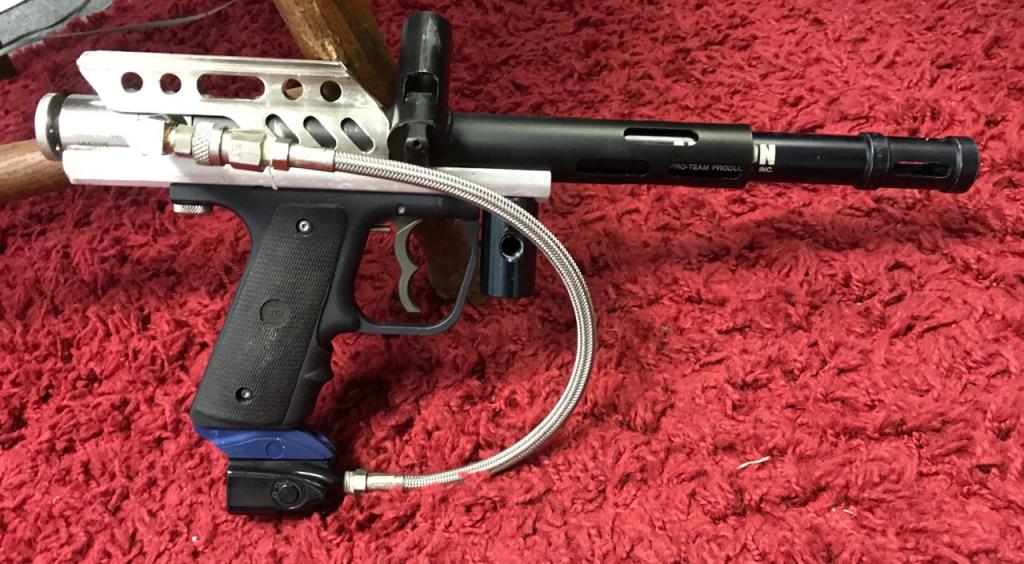

    Starting point

    Welcome to AO, and congrats on the Minimag. That's a great starting point, especially with the Benchmark frame.
    Let's see about your questions.
    Originally posted by Lanechaser
    Will I need anything different (rail, sear, etc) to install the Y frame, or is it just plug and play?
    Most mag frames are plug and play, especially the ones straight from AGD. A few of the aftermarket frames (like the Logic frame, for instance) don't fit the shorter rails, but they are few and far between.
    No. There's a significant difference between the old classic AM/MM length rails and the newer RT length rails. The older, shorter rails only have one mounting hole in the front, while most of the newer rails have two mounting holes (or they have a groove for screws). You might be able to still mount the foregrip with only one screw, but then it could spin if it's not super, super tight.
    (The old style foregrips got around this problem by having "wings" on the top that would hug the angled bottom of the rail and keep it from spinning.)
    This is a matter of opinion. Personally I think that a double trigger (which you already have) makes a bigger difference than an RT on/off. But having both certainly doesn't hurt.
    You can drop an x-valve right into your Minimag. Shouldn't be a problem.
    Good luck, and have fun.
    Oh, and if the gun has been sitting for a while, you should order a parts kit from AGD when you get the RT on/off. You will probably need to replace all the seals sooner than later.

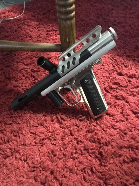

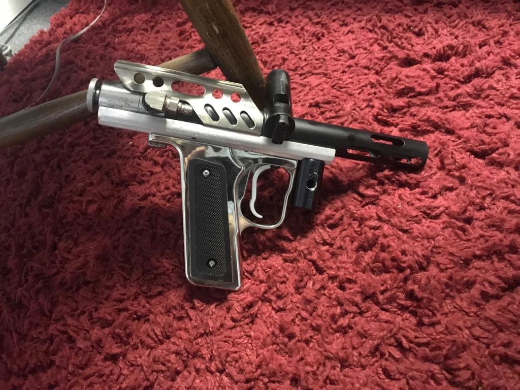

            Y frame came in

                You'll like the X-valve with Level 10 bolt. The X is much lighter with a faster recharge and the L10 will prevent chopping.
                Looks good with the Y! Consider the 9.1" Lc Wave rail over the 8" one so you get that extra bit of space to move the foregrip more comfortably forward.

                  The 9.1" Lc wave rail sounds like a better way to go. So it has a slide/groove to adjust the vertical forward or back? That sounds perfect. Will it work with the minimag body and ULE body as well, if I decide to upgrade to that soon?

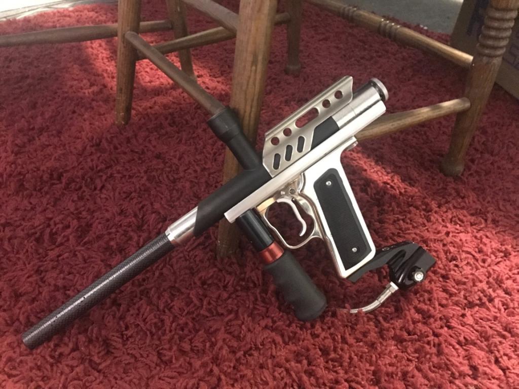

                  It feels nice and compact but I'm thinking 1/2" to 1" further forward and a 15* vertical would have a nice feel to it

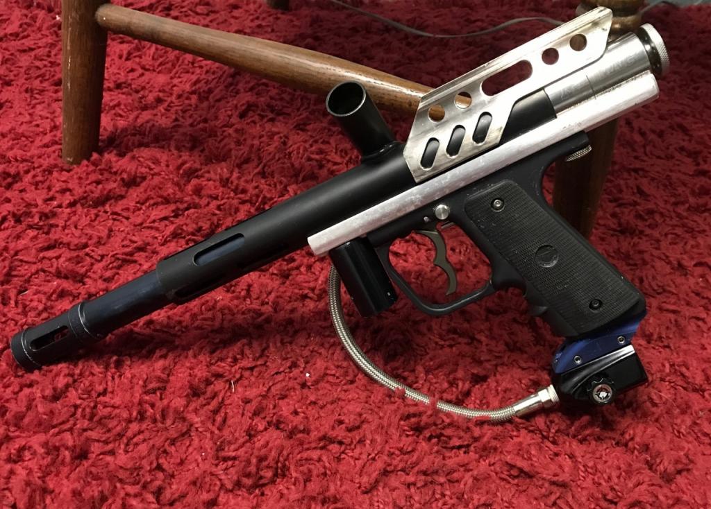

                        Alright so I have an RT on/off on the way along with spare parts to get this valve working for a backup. Going to get an X valve here soon and in the meantime I have some acrylic/pearl blocks in different colors and going to make some grip panels. We'll see how it turns out, made some for my 1911 once upon a time and turned out pretty well.
                        Progress..

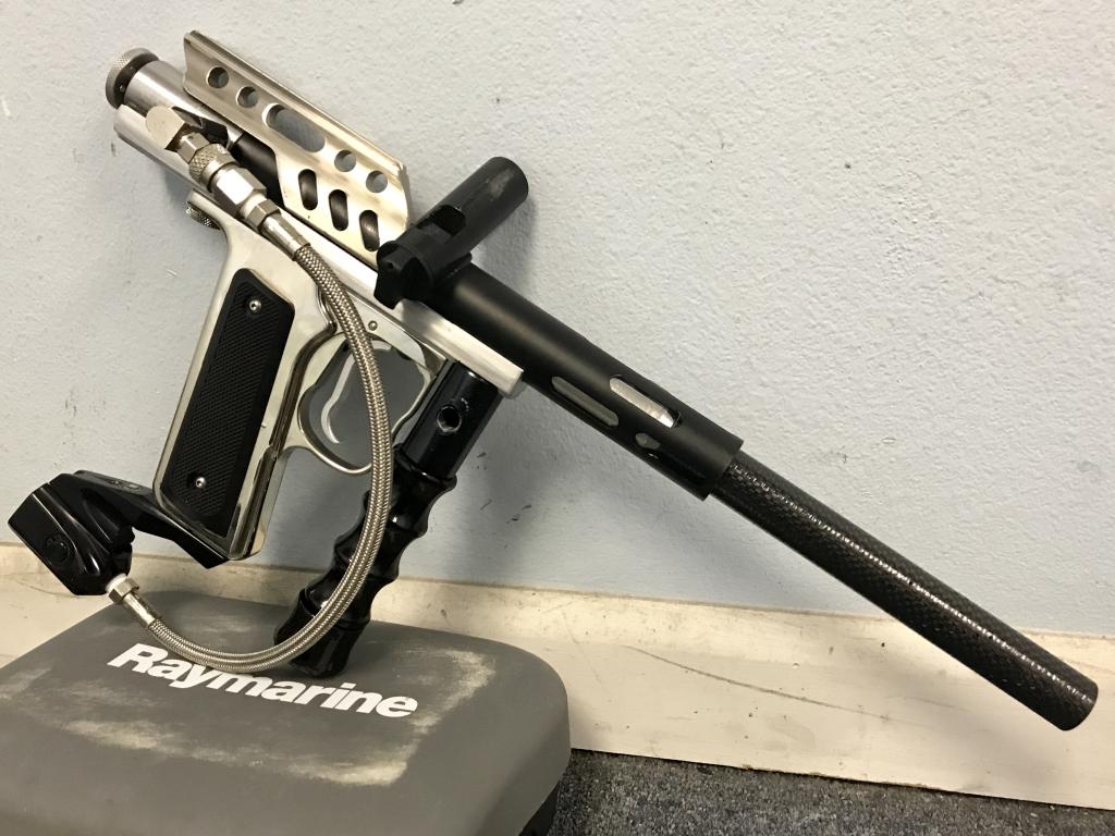

                          Changed over to a centerfeed smoke stack body. X valve headed this way in the mail.
                          If anyone has a black bike grip gas thru, I'd be happy to trade my red one. It's in perfect shape.

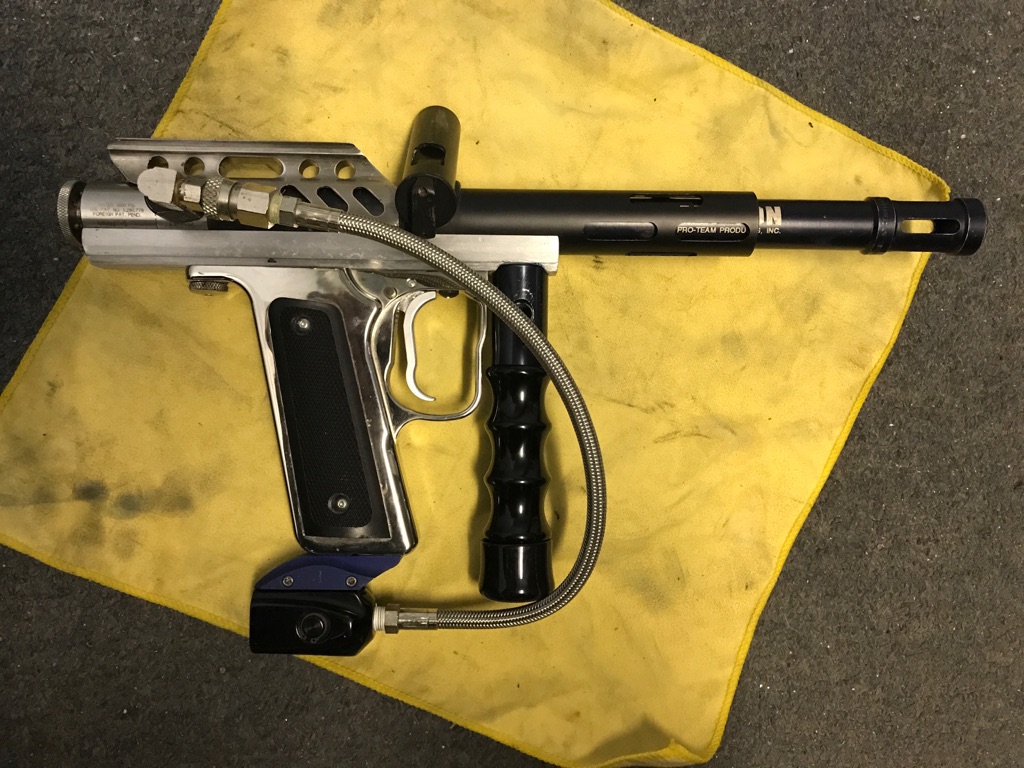

                            Trying to figure out a 15* vertical adapter that would work with my stock rail. Came across this one and looks like it might fit. Anyone have input or tried?
                            https://www.ebay.com/itm/LAPCO-Paint...oAAOSwTw5Z4RM2
                            • Walking Stick
                              Inline Mechs
                              • Jan 2007
                              • 681
                              For Cockers...so the wings probably won't match up correctly and it'll have the offset through-hole on one side for an Autococker's trigger/timing rod. Not worth the $25 experiment to me.
