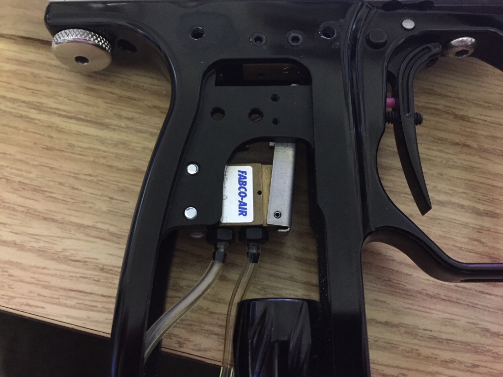

    So I was testing my pneumag and started having all kinds of problems. Leaking from the grip, bolt sticking, all kinds of stuff. So taking things apart I've come to realize the msv-2 is leaking, and I believe the piston that drives the sear is leaking as well. Are these parts rebuildable? anyone know what orings go in them if so?
    I'm going to assume lukes trex won't fit into the emancipator m90 grip. The layout doesn't seem like it would line up at least.

                  The T-Rex sits further forward in the frame than how the typical Mag frame is designed. The problem is how the frame is designed in that area on the outside of the frame, on some, the forward edge of the T-Rex will breach the outside of the frame.
                  This area is the concern on the M90>

                          • 8240
                          The T-Rex sits forward in the frame more than the standard grip is machined, it's the geometry of the outside of the frame that may be the problem.
