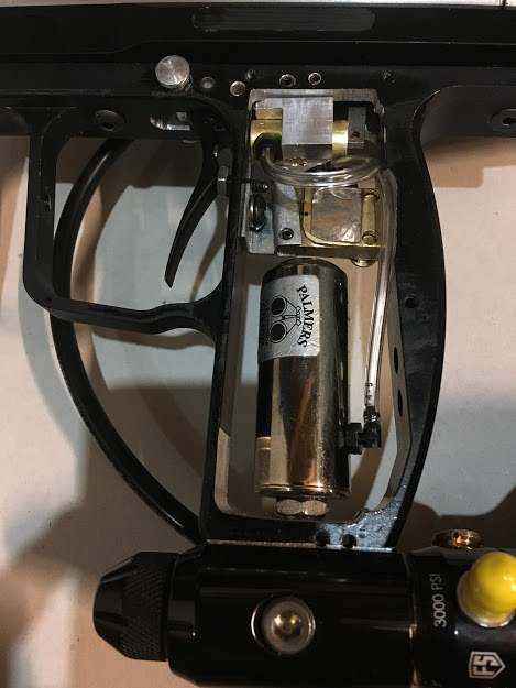

    I bought an 05 angel speed from craigslist a few years ago, and long story short it's time for a full rebuild + eyes, OR(!!!) I could try and use the frame for a pnue-mag project. I'm just a little concerenec there isn't enough room front to back for the trigger ram and sear. Are there any guides I could checkout, or pics of secessful attempts.

      You will probably have to cut off the back of the trigger to make enough space, and you definitely won't have a working safety when it's all done. But it's possible. There's enough space.
      Actually....space isn't really the biggest problem. The biggest problem is the lack of mounting options. I'm a little rusty on Angel parts, but I seem to remember that the inside of the frame is pretty empty. You can make a bracket to mount the pneumatic valve easily enough, but mounting the piston is a whole other story.
      I've done something like this before. Not in an Angel frame, but in a vertical DM3 frame.
      The basic idea is that you take a block of aluminum and drill a few holes at the top so you can mount it at the top of the frame. Then you drill another long horizontal hole to mount a piston of some kind. (I think the piston in the picture is a modified Clippard 3SS.)
      If you don't have the tools to attempt this yourself, I could help you out. Send me a PM and we can talk specifics.

        I personally don't have the tools, but I'm an engineer and I work closely with a machine shop on a daily basis. I'm pretty sure they would let me run the Bridgeport. Is going to be interesting to say the least.
