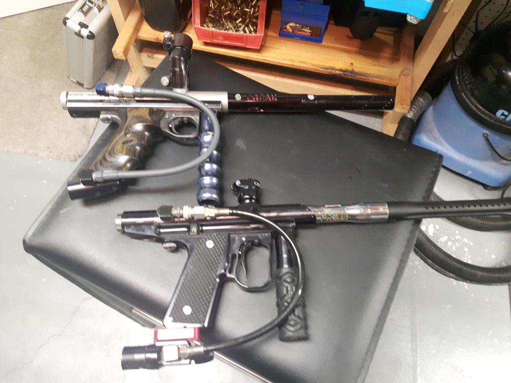

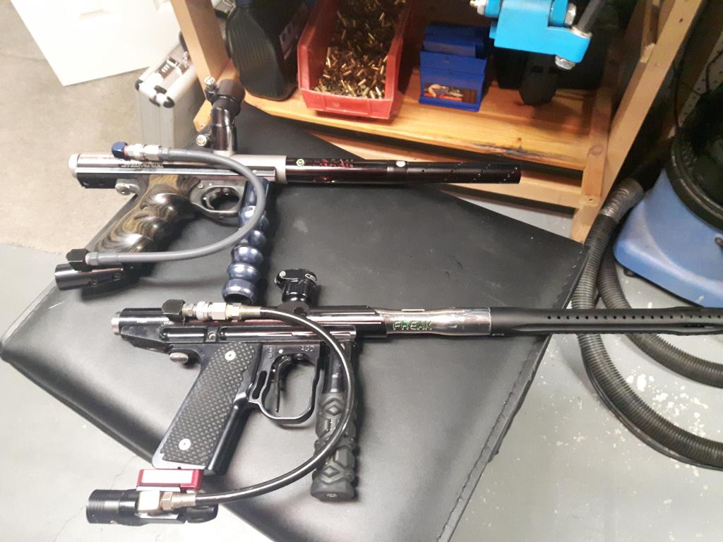

                    Yes to all those things. I feel like such a dummy now though; I went all the way through the old Tom Kaye debugging videos last night and suddenly realized what my problem was. At some point in the last couple years (probably before I had my eyes fixed) I had taken the gun to pieces for a cleaning and inadvertently put the on/off top back in upside down. Flipped it back around, per the laser etched diagram on the valve body which I stupidly didn't check, and it purrs like a kitten now.
                    Should be good for another 28 years before I need to give it anything g but oil.
                    Thanks to all of you guys.
                    In my defense, I go in and out of this stuff spring and fall and almost never have to tech my guns. Plus turning into an old geezer. [ATTACH=CONFIG]100138
