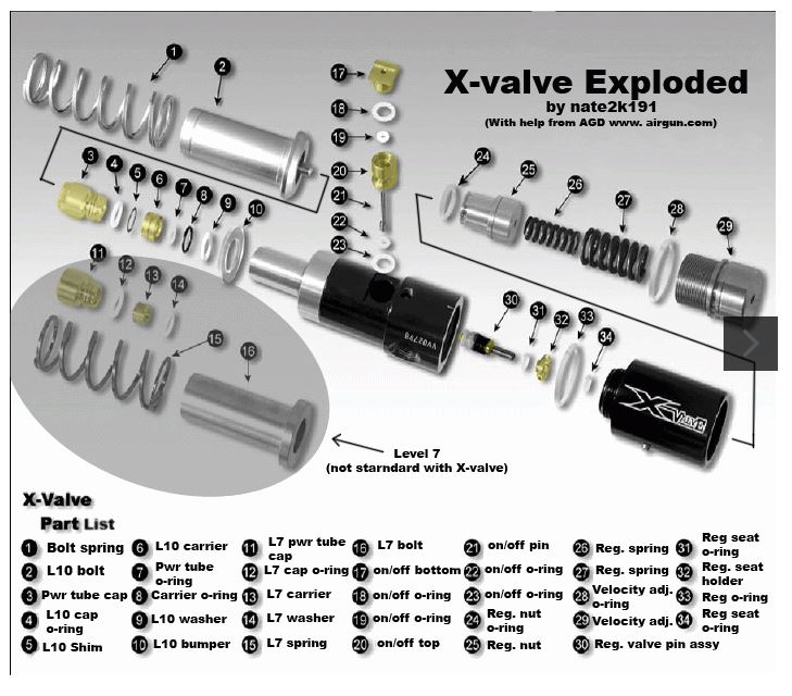

          Are you talking about 31 or 34?
Name:	XValve Diagram.JPG
            [ATTACH=CONFIG]100981[/ATTACH]
            34. I've read conflicting posts on where this is supposed to go. Just want to make sure I have it in the right place.
            Also read it may be the on/off. But the gun has no leaks when aired up with the trigger pulled. Which is also the first question asked when others are having this full auto issue.
            • Xyxyll
              Old School Airsmith
              • Apr 2003
              • 1161
              #21
              Hmm, I'm pretty sure mine (34) often push into the reg seat holder (32) with no issues. Is your trigger rod the right length?
                It is a new x-frame. Factory preset, so I've never checked it.
                It's just weird cause if I pull the o-ring out of the reg holder and put it in the back half of the valve. The gun works fine until it gets pushed into the holder.
