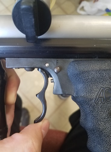

      theres actually a large space. between the back of the trigger when fully forward, and gassed up. and then there is a lot of room above the rod meeting the trigger... so that the rod moves upward where contacting the trigger. i think the aftermarket trigger is FUBAR. (unless i can make the rod extend out farther to close the large gap. ) ill try to take a picture

        This is gassed up. Crazy gap. i actually move the trigger back n forth out of habbit like it's a fidget spinner now that i think of it.

          You can definitely shorten that gap. I could drive my car through that. That's the AGD composite frame so it can't move upward's much....very little room for it to do that. Close that gap and it should feel better shooting.

            And measure that trigger rod before you make it longer. See how close it is to 1.985 inches.
              If you don't have a measuring device that can get that small, stick a credit card or similar inbetween the trigger and rod tip. That will get you very close to what is standard.

                  Hmmm when comparing the factory single finger trigger i still have, it seems like the 3rd part double trigger is way off. i imaging adjusting the trigger rod to compensate for a crappy 3rd party trigger isnt best? maybe it wouldnt matter? when Tuna says measure the rod to be 1.985 inches, is that from the end of the trigger rod to the axis of the pivot?
                      Very end of the clevis to the end of the rod.

                          Update: ended up getting an X frame and not touching the trigger rod length. slapped everything together and wow what a difference, it rips! btw i had to get a black allen head "header bolt" instead of the factory classic frame-to-body bolt. the classic bolt head is too wide and the xframe blade trigger was contacting it. as a side note. the stock xvalve on/off pin of 750 wasnt as crisp or as solid feeling as the 740 length i threw in as well.
