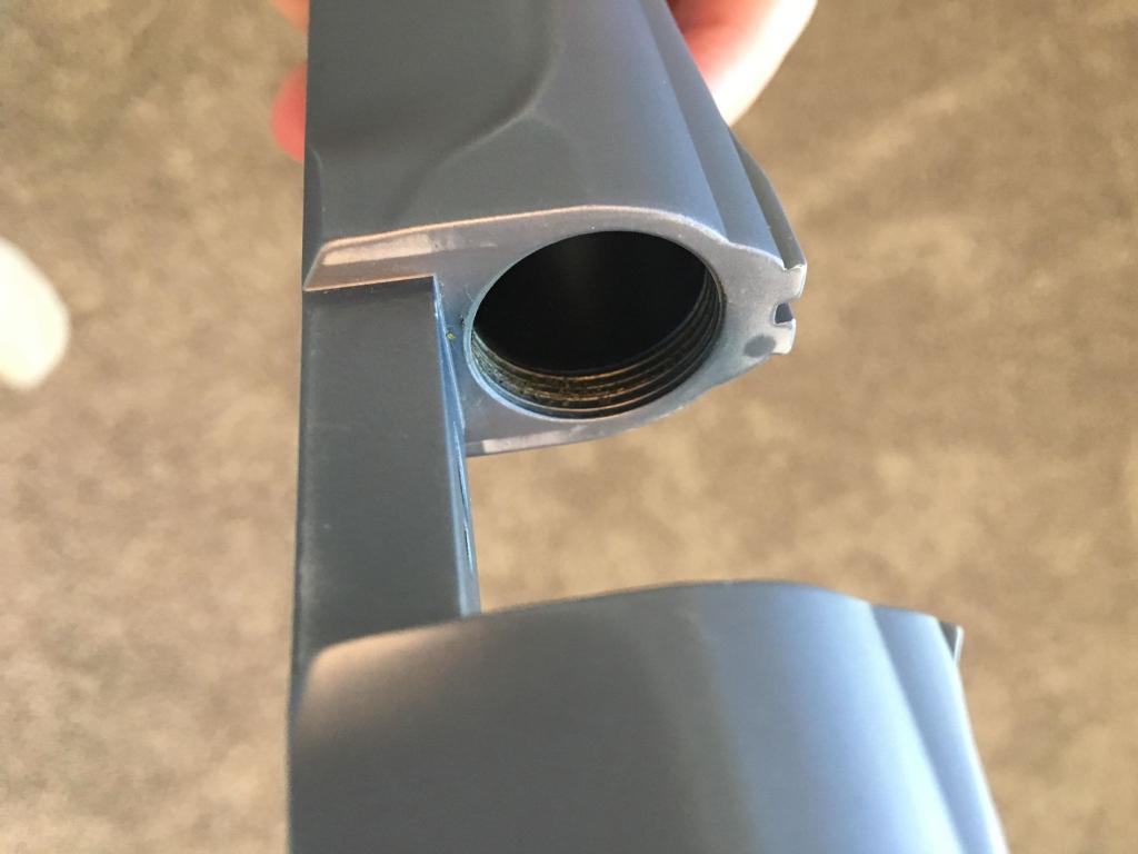

    I just bought this xmag, and am wondering what these threads are for, if it's missing a part i'm unfamiliar with. I can't figure out why there'd be threads on the back half of the body. Thanks

    A threaded steal ring goes in there.
    If you do not have that you will not want to fire the marker.
    Here is what it looks like

      Uh oh....
      do you happen to know where i can get one from?
      Thank you
        Tunaman I do belive has some extras. If he doesnt I have one.

          Is that what holds the breach in place? Always wondered about that

            No. The barrel holds the breech in place

              It's the bolt/spring stop....or the same as the washer and c-clip in a ULE or the welded ring in a classic.

                So in other words, you might want to get a new ring before you do anything with the body. Sandman/AGD and/or Tuna will have it and tell you how to install it lroperly
