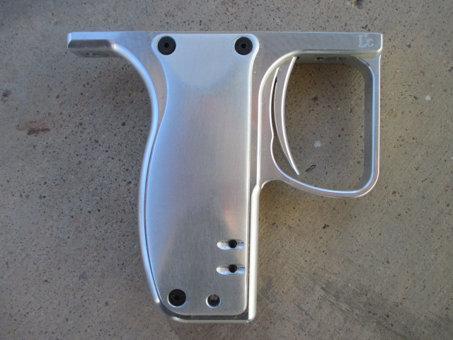

    I built Sypdermags back in the day and the trick is to use the ULT on/off.
    I also developed a new grip frame that is on hold until boards are available. This one uses a UTB which is now obsolete.
    MMMM look at that trigger stroke, that's in the FULL forward position. This thing is insanely fast! :)
    What spesific info do you need?

                Well all the math I slept through In college is coming back. If the pull on a trigger for a standard xvalve is around 2lbs then ide need a solenoid that delivers about 10newtons of force. I got my frame yesterday so ill do some measurements and bite the bullet on a couple of test noids...at least Amazon has free returns
                  • 8215
                  Where do you plan on actuating the sear with those solenoids being so long?
                  On the Spydermags I use to build I cut the sear arm off and actuated the sear directly under the on/off pin, worked like a charm.

                    I'm still shopping now for noids and need some better measurements, some of the noids I sent if the specs on the force are correct would struggle to activate it even with the ULT. Ide love to avoid cutting the sear arm because I'm cheap, But if I have to that's what I'll do.
                      • 8215
                      I would start with the frame design in order to determine what the solenoid restraints are.
                        When I was experimenting on the E90s we found that the emag on/off assembly with the quad oring works better is resets the sear more reliably than the ULT. You sacrifice a little battery life, but these 9v noids are battery hogs and you should change your battery for every day of play.
