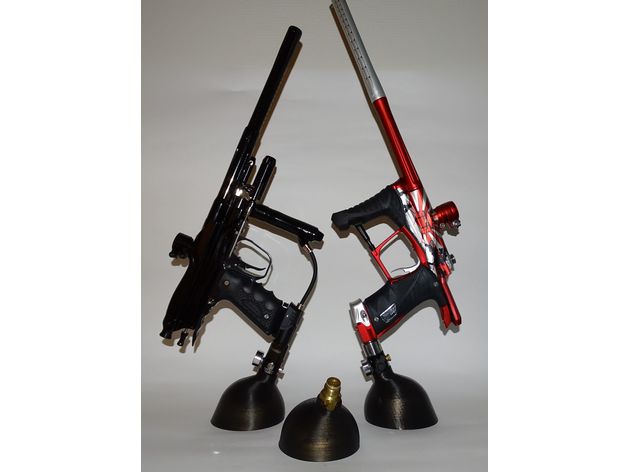

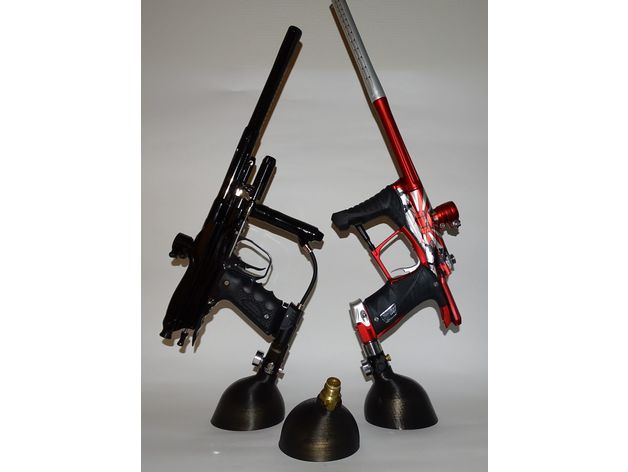

                          a guy in the uk recycles out of date tanks into gun display stands
                          they are cut off at an angle about 1/3 of the way back from regulator and filled with epoxy resin to weight them down
                          you can gut out a knackered HPA reg to save wasting a good one
