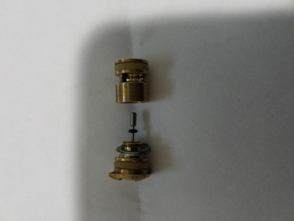

          Ok my leak is definitely in the on/off. I switched it with another gun and the leak went away. I do have some more questions though. This particular leaking x-valve has what I'm assuming is a trigger upgrade in it. The on/off has a really tiny pin and the entire on/off body is different. I went through the sticky to see if there were any pictures of the on/off that I have. I bought this gun and it already had this on/off in it. I can't seem to upload the picture here. I will try to describe it lol. It appears to be two pieces (brass) like most with a stainless steel pin through it. The pin is TINY w/a TINY o-ring on it. This on/off body is long enough that the two O-rings on the inside end are not in the standard spot or should I say not dropped inside. One of those O-rings are on the bottom portion of the on/off body and the smaller one is pushed inside of the end of the lower portion of the on/off body. I want to replace all of the O-rings, but I can't figure out which way the S.S. pin comes out. This thing also has spacers between the upper and lower pieces of the on off.

            On/Off
              • 8643
              That is a ULT. I have the rebuild kit for it. Email me [email protected]
