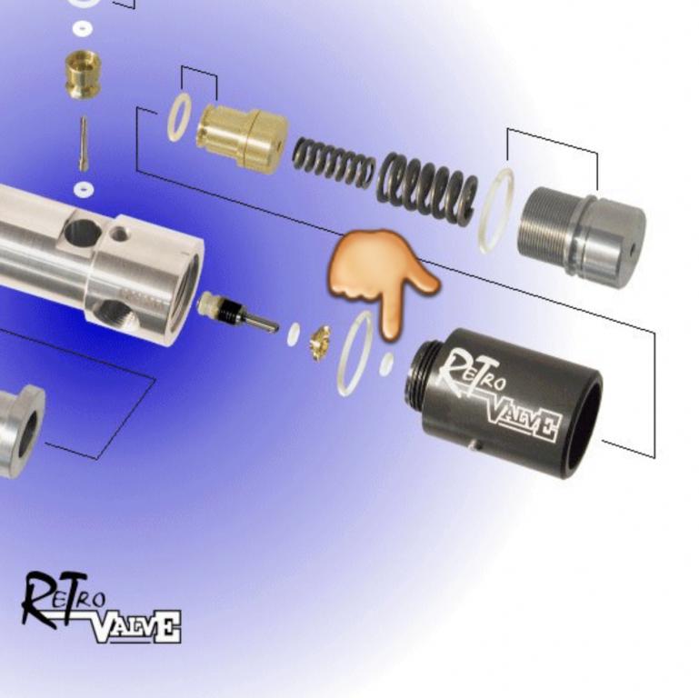

    Check your reg pin orings.
    • Billz804
      • Apr 2005
      • 334
      When this happened to me, it was because the reg pin oring on the back-side of the reg seat holder was stuck IN the reg seat holder. I removed it and pushed it into the groove in the rear half of the valve, and it shot fine after that.
