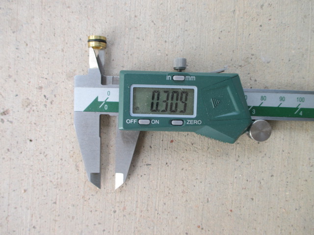

                    • 8248
                    If you have a set of calipers you can just measure the ID and ignore the marks, much easier in my opinion.
