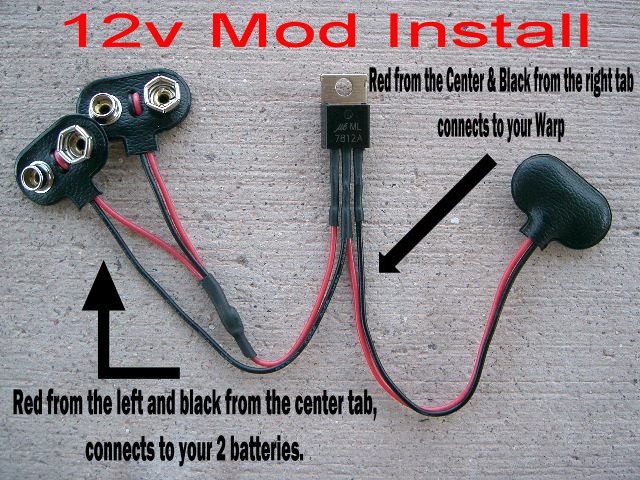

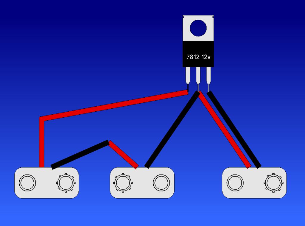

            Just to clarify:
Name:	12 Warp Mod Instructions.jpg

              Thanks! Definitely not how I took it from the first picture. So it’s just simple series through a voltage regulator then? The shrink on the battery side was deceiving haha. Looked a little like all three were joined into single red to regulator. If I were to do a direct wire instead of a 9 volt clip on the warp side (probably not a benefit other than cleaning it up a little) it would be warp black to regulator center lug and warp red to regulator right, correct?
                • 8216
                I use to make the harnesses that way just to keep it clean, the individual connections do have heat shrink on them, I just added a larger one over both to clean up the loose wires.
                Personally I wouldn't mess with the board for ease of repair if it ever needed it. There's plenty of room in the Warp housing for the harness, but if you want to take it further and you and know what you're doing go for it.

                  Thanks! I know more in the audio signal world, but some translates. Tucked and shrinked that way is definitely cleaner. Hadn’t thought about keeping clips for changing the regulator if needed. I’ll go that direction.

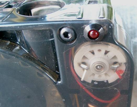

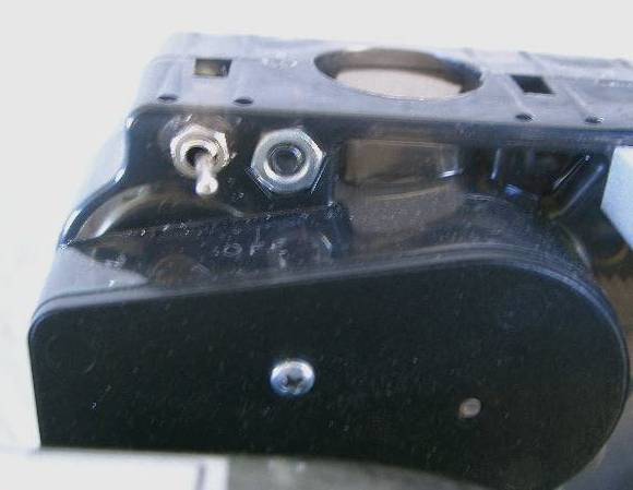

                    The only other mod I use to do on these was an on/off switch with an LED (on light)
                    I machined the housings on a knee mill
                    The light and switch were inline on opposite sides of the housing, there was just enough room to fit the parts and wiring.
Name:	Warp Light.jpg
Name:	Warp Switch.jpg

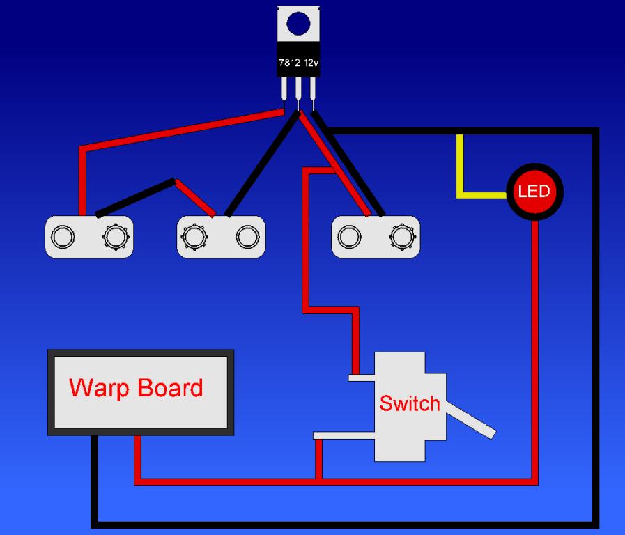

                      • 8216
                      On/Off LED wiring
                      Radio Shack LED 276-011
                      Switch 275-624 or 275-0645
Name:	Warp On Off With LED.jpg
