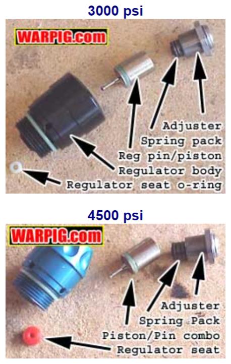

      Well I'm certainly not looking to endanger anyone. It's why I'm here asking about it. You mention there are no seals... can you just help me to understand what seals you are referring to? I'm not trying to be a PITA here, I'm genuinely trying to understand the differences.
      I found this and can see some differences...
      Hence my asking about the seals.
        The 4.5k regulator seat is the seal that is currently not made anymore although we do have a thread trying to source some. I suspect it will end up turning into a collaborative group project. (https://www.automags.org/forums/show...line-Reg-Seats!).
        as far as converting a 3k flatline to a 4.5k flatline the differences i see are the piston, reg seat, front regulator assembly where the reg seat sits and the burst disc. I am sure there was a reason for agd to change the reg seat from the oring to the urethane disc seal though.
