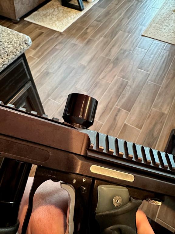

            I appreciate the help, I purchased one of the Inception feed necks and it isn't compatible. Included is the current feed neck that won't accept modern hoppers - I think it may have loctite on it because that sucker is firmly in place.
            Any suggestions on how to proceed? I'm open to whatever.

              Automag ULE/Tac-One bodies have Angel threaded feed necks. What makes you say the Inception Designs isn't compatible? You need to purchase both the links that captian pinky provided.
              Pad the jaws of a vice with blocks of wood or plenty of cardboard. Remove detent. Use a lighter to heat the base of the feed neck, slowly going around the circumference for about 2 minutes. Quickly clamp the feed neck tightly in the vice. Unthread, using the body for leverage. Don't apply too much force. If it's still not coming unthreaded with reasonable force, apply more heat, and repeat.

                Originally posted by nak81783
                Automag ULE/Tac-One bodies have Angel threaded feed necks. What makes you say the Inception Designs isn't compatible? You need to purchase both the links that captian pinky provided, although I would go with the low rise Angel adapter
                Low rise adapter will not work with the tacone body.
