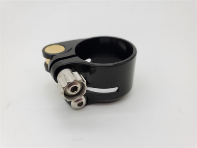

Are there any recommendations for low-rise clamping feednecks to use on an AGD ULE body?
Has anyone tried the latest inception designs feedneck with angel thread adapter? The inception designs feedneck is definitely sleeker looking than the option from CP, but is pricey. So I thought I’d ask around before taking the plunge.

I would avoid the cp option. They had issues with getting the angel threaded ones and the smart parts thread confused. While the smart parts thread will go in, it has significantly less thread engagement and can be ripped out.
I really like the inception feednecks. I also stock them. I do have angel adapters in stock aswell although they have not yet been added to the website.
FLE Feednecks are the lightest and lowest profile feednecks available. Now the "V2" comes with a larger stainless steel thumb wheel (so your anodizer can't lose it in the anodizing vats) which is easier to hand tighten, a slightly tighter grip on small hopper feednecks (like those from Virtue and BK) and it no longer hComment
