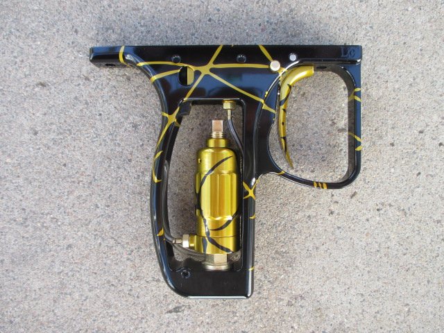

          Originally posted by paintball4lyfe32
          Are there any trigger frames that would improve performance?
          Yes indeed, I have 7 frames to choose from, all pneumatic or mechanical without any necessary modifications.
          Lc MP90d>
