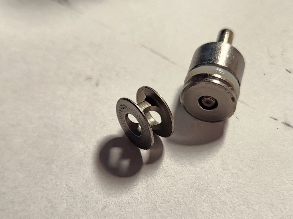

    I got back into paintball after 22 years away and wanted a Automag again (really just want my gen 3 micromag back, should have never sold it) so i purchased a basket case of a marker off of eBay with spare parts and a classic valve. I have put a rebuild kit into it and it shot fine for the first 500 shots but now has developed a bad case of bolt stick. The power tube spacer installed in it is a .220 and i think it is the wrong size for the ANS Phase 2 bolt that came in the valve. Airgundesigns.com is out of the spacer kit so i am going to make some new ones to test to fix the bolt stick.

    1. What is the correct inside diameter of the power tube spacer when new? Mine checks .254", but i am thinking that it could be worn. I want to ensure that the new power tube spacers have the correct ID.
    2. Bonus question: Can someone identify the on/off top used in this valve, and should i replace it with stock? I can't think of how it would negatively affect performance/reliability, but maybe it could?

    I have a small mountain of powertube spaces and i think it is aka.
      • 8648
      all the powertube spacers have the same ID. The length is what is important. If it is leaking try a longer one.

        Ok. So it is probably the correct ID and if it was locking up (as in bolt was really hard to remove from valve assembly) , but not leaking, does that mean a shorter spacer?
          Thanks! So it is a legitimate component and not some modification / mutilation of a factory part.

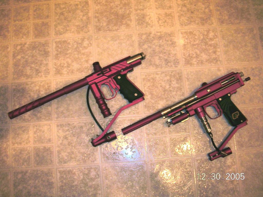

              Photo for fun, this was my MicroMag and 2k Autococker i finished building both in 2003 but then stopped playing that year (the autococker is right feed was milled for the eblade eye which was fully functional). The photo is from 2005 when i was selling them. Should have kept the micomag. All barrels and accessories were anodized dust red to match each other.
Name:	DSCN0924 (Large).jpg
