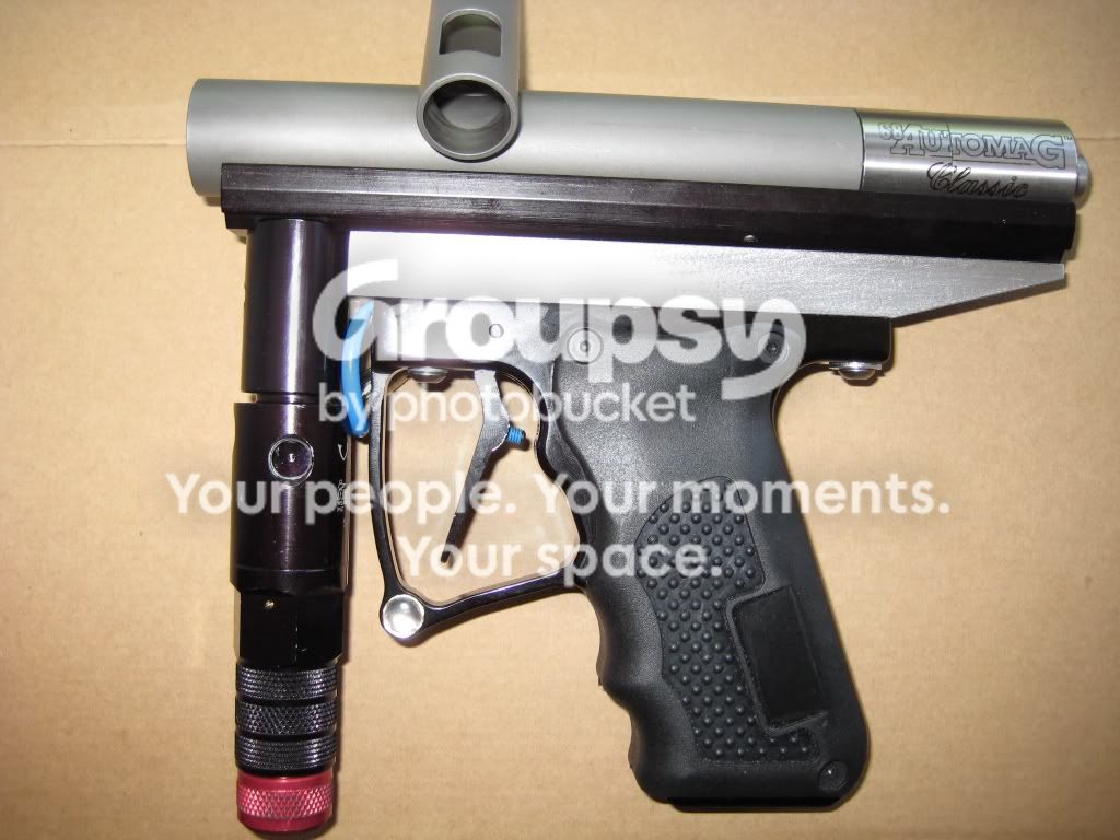

So I made a new adapter to incorporate a push connect. Unfortunately a 4mm push connect has to much rise on it to clear the trigger in the frame. There also was not enought roomt to fit a push connect on the noid, so I was stuck with the stock barb 3mm barb and fighting to get the standrard 5/32 hose over it. Yes it can be done, but its a battle.

Finally the bench assembly:
Test fired the first time I tried it with the grip frame off ! With the frame on I had to shorten the hose to the actuator as it kinked behind the trigger. Works great now, the new adapter also solved another problem I didn't know I had. The original rail was only 1/2" thick, and the sear was pressing into the top of it requiring full pressure from the LPR to fire it. I left a slot in the top of the new rail for sear clearance and increase it's thickness to .600"
I extended the rail to the back of the mag rail just for looks and chamfered the end to blend it in a little. I think it looks much better personally.
