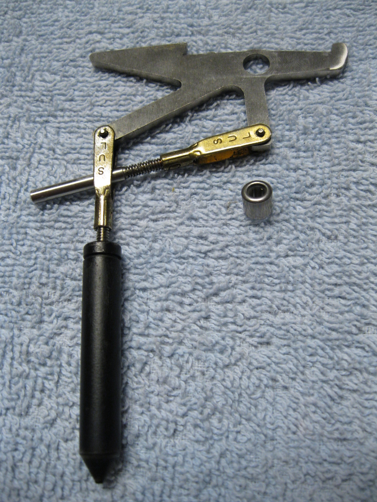

    Time for the mess that was the sear. As pointed out earlier, the bushing that keeps the sear centered in the rail was ground flush with the sear, meaning there was a ton of side-to-side play. In addition to that, it had been drilled out so it wasn't even a tight fit on the sear pin. I have NO idea why anyone would do this. Basically this sear was not only completely out of spec in every way, but it was just flopping around like a fish out of water. It would need to be adjusted and have a new bearing pressed in.
    Here i've already pressed the old bushing out using a large clamp and some sockets, and have the replacement bearing waiting. The bearing was ordered from ebay from a bearing wholesaler and measures 1/4" OD, 1/8" ID and 1/4" wide. This is the same type of bearing that is used in RT classic sears.
    And here we have the sear all done:
    The bearing was carefully pressed into the sear using the clamp. Once it was flush with one side of the sear, a large socket was added so I could press the bearing through. Progress was checked frequently with my digital calipers to make sure the bearing was centered in the sear. The trigger rod was removed (it came out by hand, that's how loose it was) and cleaned up, blue loctite was applied and the length was set back to the correct 2.125" (it was 2.165" before). The solenoid plunger was set at 3.005", and is kept in place with a new 4-40 locknut (which was missing before).

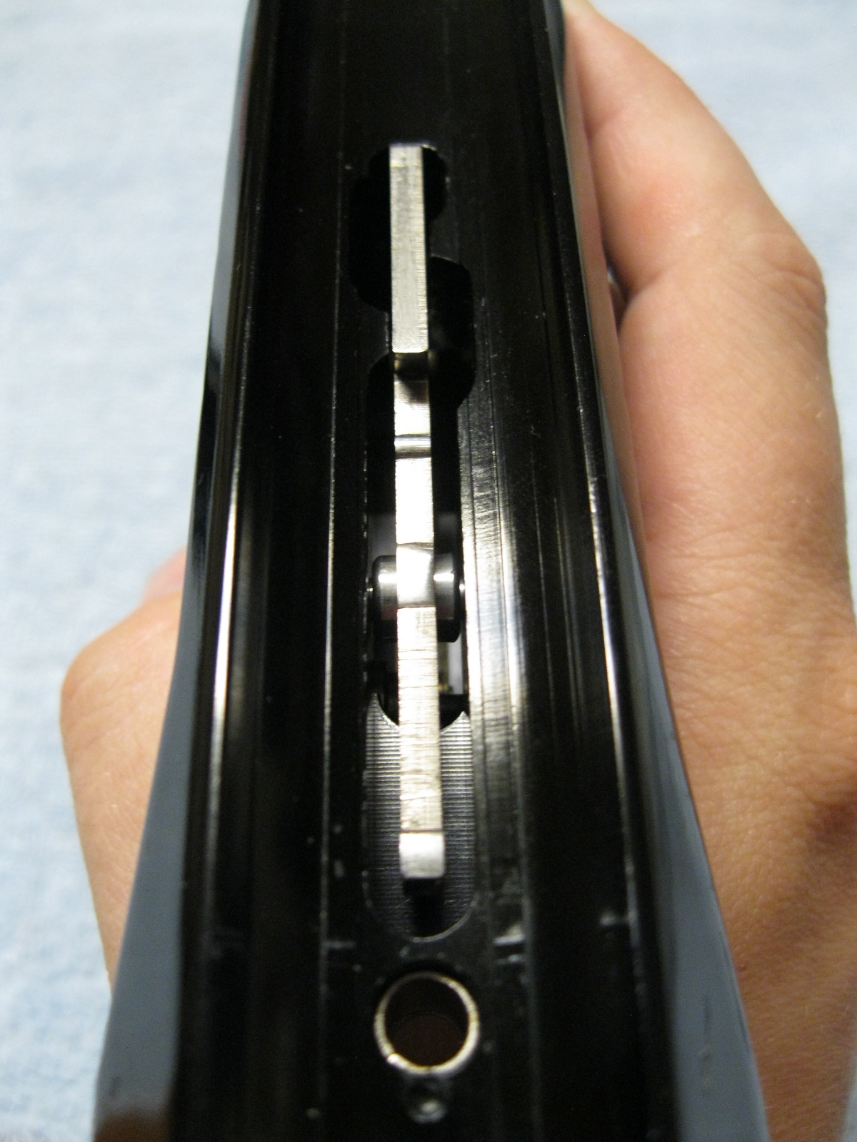

    Let's see what it looks like installed:
    It's 100% better...no slop at all!
