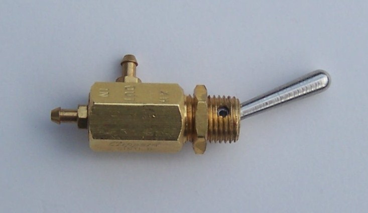

    Has anyone ever tried to put a (edit) two position valve on a pneumatic trigger circuit?
    Vent the ram in one position, connect the ram to the trigger valve in the other.
    I have to think that around here someone would have at least tinkered...
    Any thoughts would be appreciated

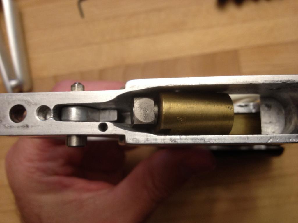

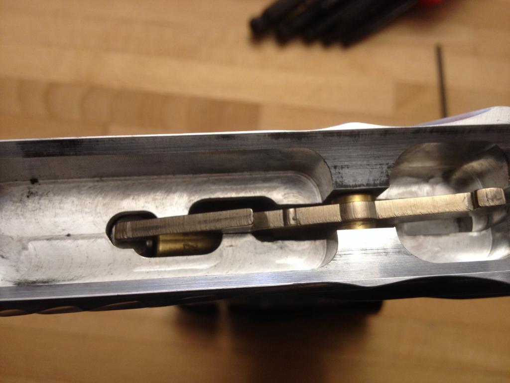

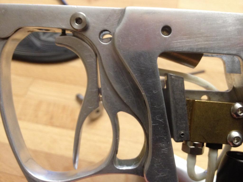

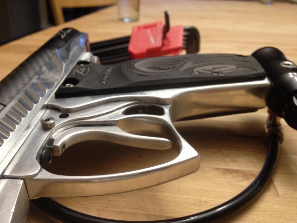

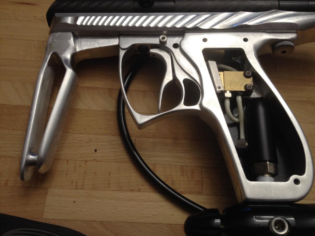

                    wat trieer frame are you using? any pics of the current set-up?
                    • Spiritchaser
                      • Feb 2013
                      • 112
                      Heh, it's actually the airwalk you helped me find a year and a half ago
                      Though it has changed a bit since then

                        use a longer trigger rod and then re-adjust the trigger stops.
                        has it been a year and a half already?
                        • Spiritchaser
                          • Feb 2013
                          • 112
                          It's been a while
                          I can change the rod to reposition the safety tab or (more likely) file it to where I want it, but there is very little motion at all at the tab with such minimal trigger pull
                          On Friday I'm going to play around increasing the pre travel until it feels slow and see if maybe I can make it work
                          The trigger is a home built, I plan on making it work. I'd much rather file it, and keep the trigger right at the back of the trigger area for more room.
                          The trigger rod is delrin, and very easy to work with, but I don't think that on its own can do what I need
