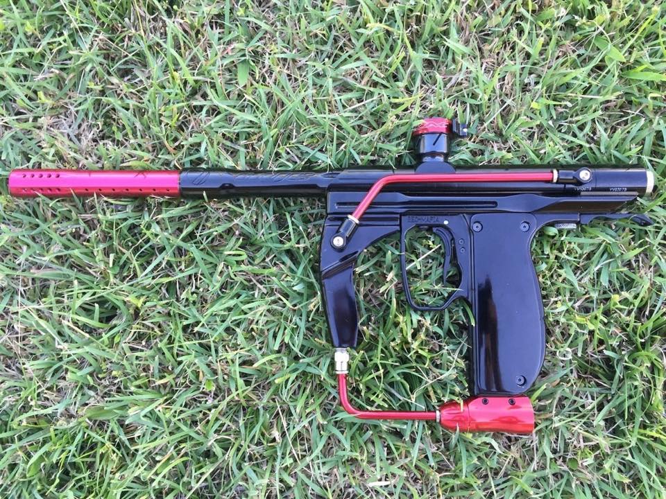

    I've seen them around the forums periodically, solid air lines custom shaped to guns.
    I have a Tac One and would like to figure out how to do this for myself and a couple friends. Anyone know a good resource to get started?
    • 8240
    I buy line in 6 foot lengths but most guys just use this

      Daaang! Luke himself
      Thanks man, any pipe bending tool or fittings you'd recommend? I'm a rock-banging ape i'll dick this up if i'm left unsupervised haha

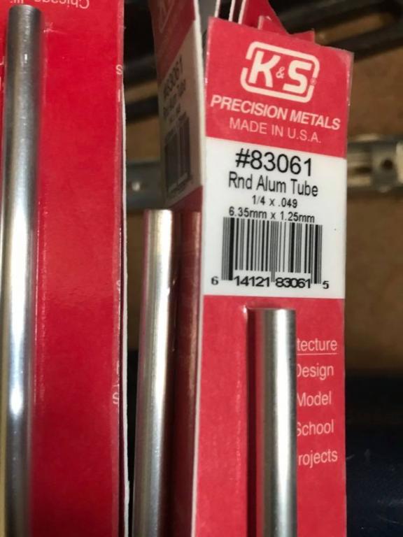

      [ATTACH=CONFIG]103586[/ATTACH]
        any hand held tubing bender will work, it's like bending new break lines on an old car.

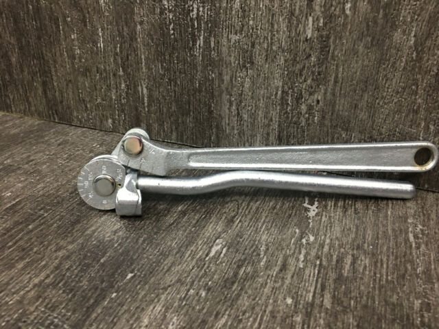

          • 8240
          You will need a 1/4" tubing bender. I prefer the older Parker tubing benders over the modern ones.
