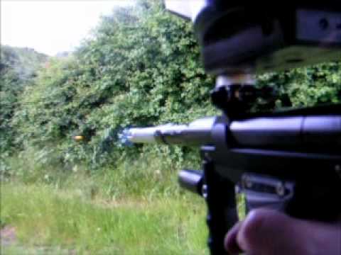

      How fast is fast enough ?
      Level 10 no eyes :
        I NEVER get tired of seeing that video! LOL
        Notice how well it shot with the loader off? Can't do that with eyes. For the most part, both will do the job. If you are talking about eyes for a mag, then there are other factors to consider. A lvl7 bolt w/eyes is considerably heavier and will add noticeable kick to the gun. I know, Ive tried it.
        Also, you really want to have a foamy. I always tell people that anything they run with a lvl7 should use a lvl7 foamy bolt.

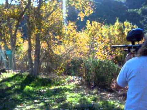

                      Lvl 10 , no eyes, no ramping , no rt pure semi.
                      Enjoy the videos and music you love, upload original content, and share it all with friends, family, and the world on YouTube.
