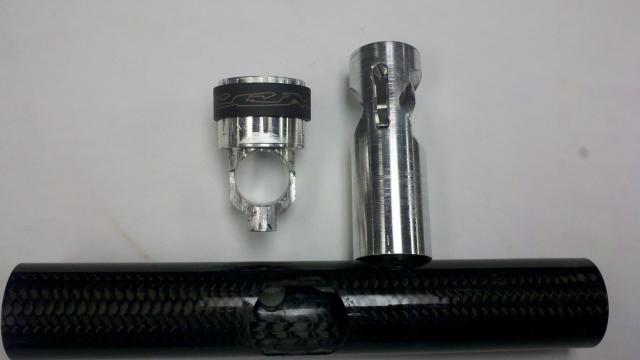

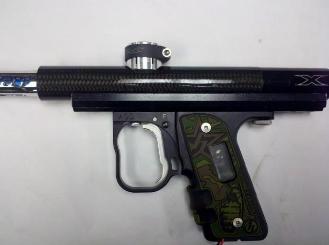

    I have been working on a full Carbon fiber body with clamping feed neck and autococker threads. So what do you think? [ATTACH=CONFIG]87662
    nice idea,
    but you need to reinforce things,
    and that feedneck look alittle, not right.
    but good prgress.
    but definently has been thought of before.

      What needs to be reinforced? The feed neck is the same as a CCM angel thread no rise just shorter. If it was thought of before I haven't seen it.

        How'd you reinforce the lug inside the body that the spring seats on? That's the only real failure point... have the bolt barrel and a paintball going down the feild... id actually pay to see it.
        Looks nice and clean though, good job on it

                Eh, don't let em bring ya down. And that's coming from the guy with the negative opinion on everything. As long as you've got the breach area dialed in there is no reason for itt to work....
                That being said... I don't see how a 8 thread feedneck made I into a 1/8" thick body. The thread space on my ule is about 1/4". More detailed pics would be great

                  If the dimensions of the carbon fiber body are the same as a ULE body, the savings will be about 2oz. The key to making a successful body, will be using a good epoxy resin that has good structural properties so the body stays rigid. They do make epoxy that has good rigid properties, but it usually lacks in wear ability and vise versa. If you can find a good combination, you might be able to build the body washer into the body design so that it will absorb any impact without permanent mushrooming. The other option would be to mold the steel body washer into the body when the body is being poured.

                    The feed neck is not threaded, it goes all the way through the body. It has a nubbin style detents similar to the twist lock barrels. I did not use epoxy on this, it comes apart to be able to change detents and to clean it.The detents don't go through the body. 2013-02-01_carbon fiber inner2.jpg

                      That's pretty slick. All doubts have been alleviated!
                      Nice work. Good to see something done and not just talked about
                      So is that pretty much just a docs machine adapter further milled to fit the neck and be the body lug/ spring seat? If that made sense, haha

                        That is pretty sweet. And looks like a decent amount of time has gone in to it. And deff thinking outside the box with that feed neck. I like.
                        Interested in how this holds up long term.

                              I do like the design of the feedneck. It is and interesting concept, and as long as it can hold the body from moving, it should provide stability for the hopper. Is the body insert made of stainless or aluminum? If it is an aluminum insert, you could put a steel body washer behind it to provide protection. If it is steel, it will probably be ok as is.
