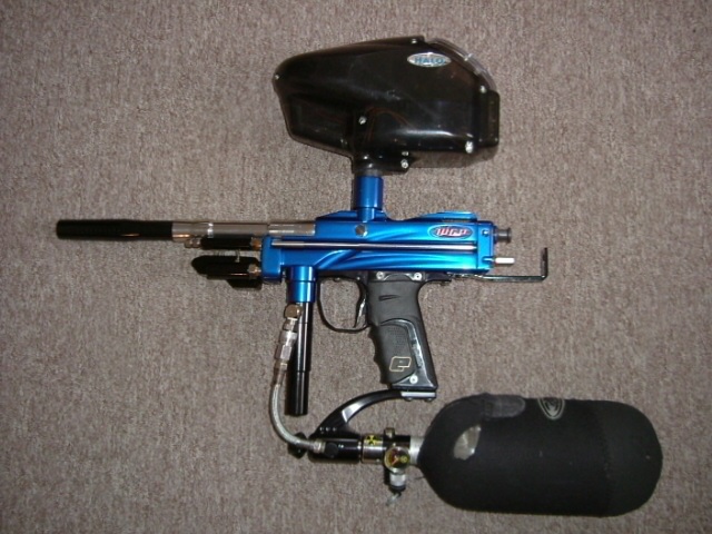

        E2 Autococker. I do a nearly complete tear down and lube every 6 - 12 months. I say nearly because I don't have the tool to unscrew the vertical ASA, plus I think it's red Loc-Tited. I also leave the ram alone and only partially tear apart the lpr. I completely clean the solenoid, which always scares the crap out of me, as does unplugging wiring harnesses. I haven't done a ton of research, but I assume these things are difficult to replace.

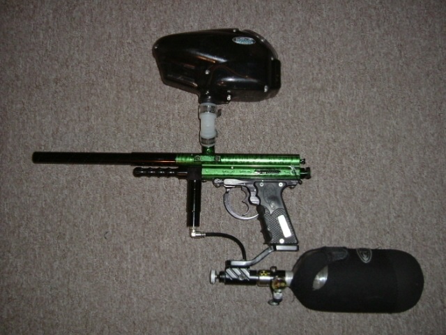

            I wish I still had my Spyder. I converted a Spyder SE to low pressure and electronic trigger frame. It was right when Halos came out, so that was the cheapest way for me to get to maximum bps.
            I had a Palmer reg on there, but later moved it to my E2, and put the stock cocker reg on the Spyder.
            Believe it or not, the Spyder with All American barrel and All Star paint was incredibly precise. I pulled off some of my best one shot eliminations ever with that rig.
            In the context of this thread though, the Spyder is the opposite. Extremely easy to tech. Almost as easy as my Mags.
