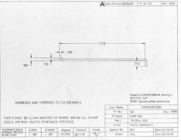

        honestly if mine comes with a .125 rod im going to pull it off and make my own. is not hard to do just requires a die and correct rod. im sure he did the .125 rod because its easier and cheaper to get. i believe the correct diameter is 3mm if i remember right.
        did find these on my computer though
ID:	2183509Click image for larger version

          Wouldn't you need to get a new back plate. If Rainman tapped them .125 how are you going to thread in a .110 rod. You'll either have to get a new plate or fill the hole then rethread it.
            #65
            it will not be perfect but i do believe there is a range in which the threads work. but i might even try throwing it in a drill and sanding it until it worked. its been along day not sure if that made since.

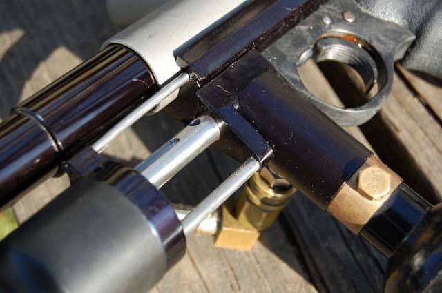

                        well here is a post of his pump kits that clearly show that there is no gap between tha rail pump kit mount...maybe that was before day one tho...haha...oh wait thats not possible??? my last Rainman229 pump kit didnt have a gap and it didnt have any binding issues on any rail that was used.
                        http://www.mcarterbrown.com/forums/r...-thread-4.html
                        that little gap is most likely wats causing tha binding issues....and as quickly as yall put your money in his pocket to get him tha cashola to do this run...he should have no problem fixing a mistake. id be pissed!!!
                        No my pump kit mounts exactly the same way ya'll is mounting I do have the gap just like the current ones.
                        I've had to adjust the rod externaly since the mount point on the plate and the slot for the rod are not perfectly aligned and it caused intermittent binding. Once I had my rod adjusted to go straight into the pump slot I have not had any issues for the last several years and its is my primary.
                        The gap isn't the issue the pump rod needs to be adjusted externally to line up with pump rod slot and the binding should disappear.
                        Notice the curve of the pump rod between the pump plate and rail.
                          #72
                          The pic you posted is a gen 1 kit and that issue should have been fixed before this run.
