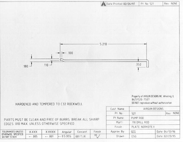

                          Here is the AGD Drawing. I got it back when I bought my blem pumpmag parts from AGD's Attic sales. Im assuming since they posted it for everyone back then that its still ok to post now. It seems to have been lost where ever it was origianlly posted.
                          I used that drawing as a guard and bent a rod out is a coathanger. Its been 10+ years and its still going. I wouldnt change it for anything.
                          Anyway you can get the material from McMaster.com http://www.mcmaster.com/#drill-rods/=nmvs7i
                          You will have to pick the right size & such in order to pull up the correct stuff.
                              [ATTACH=CONFIG]88022[/ATTACH]
                              If I am reading it correctly, it is calling for using some pretty hard stuff. Would somoene have to heat this up to bend it?
                              And FTR, I did go out and grab a piece of 1/8" brass rod and IT DOES NOT FIT the pump channel. At least not on the pump handle that I have. With that said, there really is no reason the pump channel couldnt be opened up a bit right?
