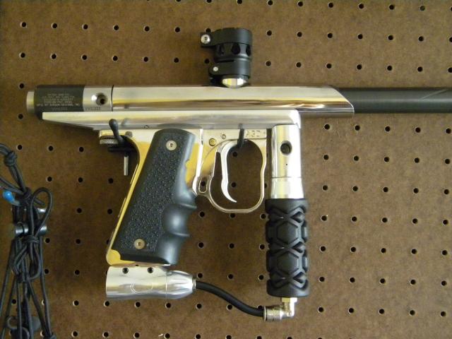

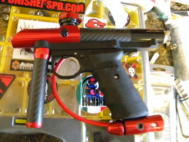

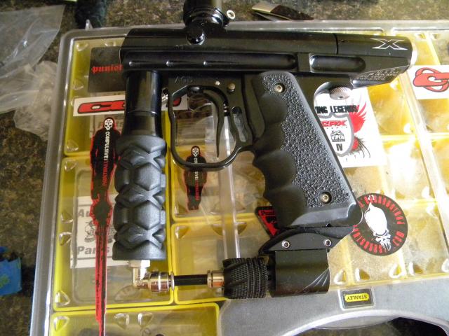

    But here is a comparison of a couple of setups:
    2.26 lbs with a DW Carbon Fibur barrel
    2.84 lbs as pictured. Probably 2.9lbs or so with two more macros.
    IIRC, this one came in at something like 1.6lbs? Going from memory since I parted most of it out...
    So really even with a DW CF barrel, ULE body with CF Insert and XvsRetro valve, we are really only talking maybe a 10 oz difference (which I'm not going to lie surprised me). But another thing that makes the Retro setup weigh more sometimes is when I use the 90CI tank with SHP reg which adds another 1/2 lb.
