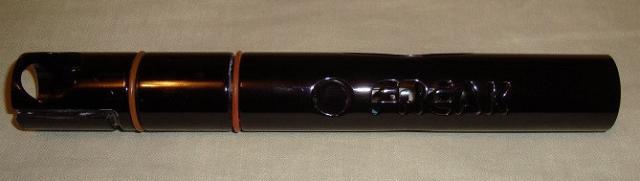

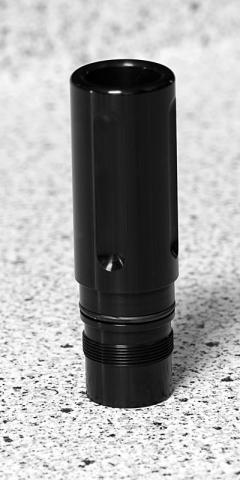

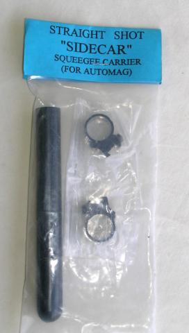

    Step #3: Buy on Ebay an old school squeegee side-car adapter, a WWA Freak tip, 32* Single Trigger Frame (thanks I&I Sport. Had to drill out inside, but it's working great now) and AM Freak back (Lucky find). Also buy some black 10 round tubes and a 18ci tank. (STILL LOOKING FOR BOTH!)

    Step #4: Buy 15* AM Vert ASA and drill XM15's pump kit to take the reversed 15* AM VASA.
    Step #5: Buy 2X Empire Spring Feed Tubes (bought one on AO and the other on MCB).
    Step #6: Have Luke (or some other inferior machinist *edit: inferior to LUKE) make my AM pump body have 2 feedtubes.
    WORK IN PROGRESS.... Basically standard body cut down on both sides.

    So far things are coming along. I know the biggest question someone will ask will be how are you going to get the balls to feed correctly in a body that has 2 feed ports. Well the trick will be in the twist-lock freak back. I'm going to make it so I can twist the barrel from one feed port to another once one tube of paintballs is done. The barrel or the powerfeed plug from the empire spring feeds will stop the balls as well. I have an aluminum cocker barrel adapter that might work a lot better then the freak back, but I'm going to try the freak back first. I already have the standard pump body that I'm going to have converted. Just need to sweet talk Luke into doing it for me. I want the body to be standard feed cause that will allow me to use elbows and put mini-hoppers on it if I want to shoot more paint. I like options.

                  The 10round tubes on the sidecar are just to house extra paint that I can feed into the spring feeds if I run out. I wanted a way to carry extra rounds onto the field but not have to pocket them so I thought it would be cool to have an extra 20 rounds on the gun. In the end there should be a total of 40 rounds available on the gun. That's more then enough for a good long game or several short speedball games.
