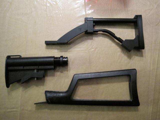

    Well OPBN ask the question and I was the guinea pig
    http://automags.org/forums/showthrea...Will-this-work
    First step was to check what was preventing the two from mating
    as you can see they are close but material needs to be removed for the AGD frame to fit
    i cut the back off the stock because it was in the way of the rear screw on the frame
    as I refit and cleared away more material from the stock the frame became easier to insert
    I wanted to maintain the channel the posts on the frame ride in, but on the crossman frames the geometry is slightly different.
    I took a used cutting wheel and cut the channel straight back. I used the painters tape as a guide
    i cleaned up the front and checked alignment again, and marked a spot for the new hole from stock to frame
    using a hand file and sandpaper i cleaned up the back
    Drilled and tapped the hole 10/32
    ...and BOOM!!!

          Originally posted by OPBN
          How secure? Any wobble?
          very secure no wobble at all. you could even put mounting screws into the bottom of the frame as well

                  total cost?
                  • rukh013
                    • Mar 2012
                    • 624
                    $22 shipped to the wally world down the street... and a steady hand to cut it
                    old AO feedback
                      sorry, I meant time spent and misc cost.
                      22$ +.... ?
                      I was just looking to compare, I have 3 of these stock previously mod'd and done about 3 yrs back. didn't know they were that big of deal.
                      just comparing cost to a production stand point.
                      thankyou,
                      KNM.
                      • rukh013
                        • Mar 2012
                        • 624
                        it took about 30-45 min, I made sure to use tools most people have: Dremel, cutting wheel, high speed cutter, 1/2" half round bastard file, sandpaper (220 then 500) and tape as a guide
                        if i did it again i could do it in 10 min, there wasn't much to it. the checking the fit as i went was the most time consuming
