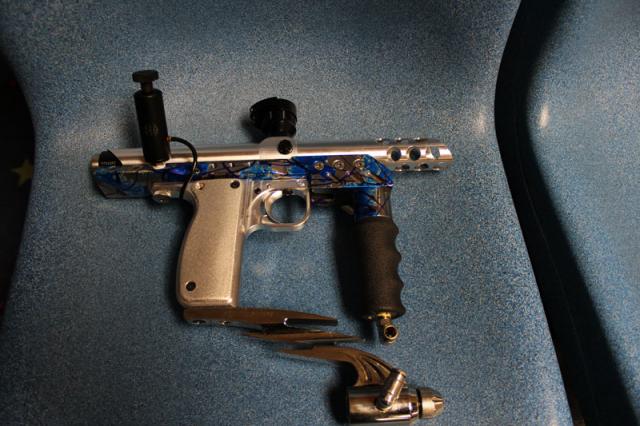

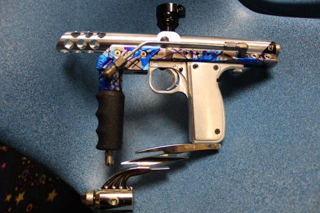

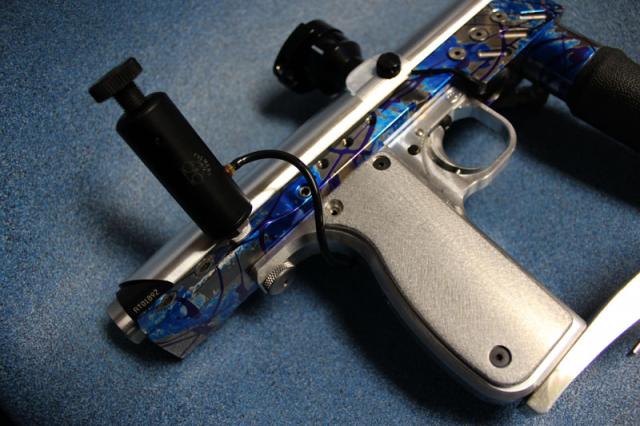

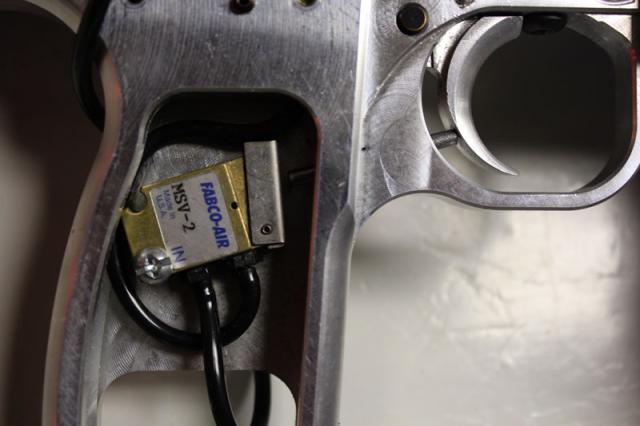

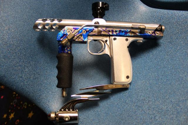

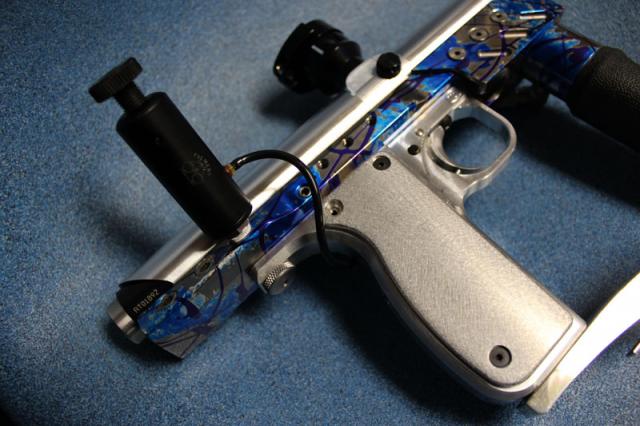

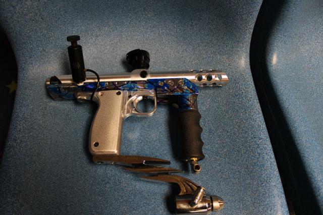

    This is the first Pneu-job I've done myself. It's actually been done for months but I noticed Luke mention that he hadn't seen any of these frames pneu'd yet. My goal is to incorporate as many AO products on here as possible.
    Specs so far:
    LV 10 classic RT
    Lukes Vert Mini single trigger
    XMT AL classic RT body
    Mag79 pneu kit
    Palmers Micro-Rock
    would love to see an AO made drop and ASA to replace the CP parts on the bottom.

      LOOKS SO GOOD!! Ahh you beat me to it, just on the wait to find parts. I might be the first double trigger. Fingers crossed. how easy was the placement for the ram?

        on a side note... do something else with the reg, put a 90* elbow on it or something
        No way! I love it like that. Reminds me of the Junon Cannon from Final Fantasy 7. I'd love a functional excuse to stick four more on the other open ports just like it. Where the hell are my air powered accessories!

          Damn too bad these frames weren't made to be ready for a pneumag…they really don't look like there was much room in tha frame?
          how does it shoot?

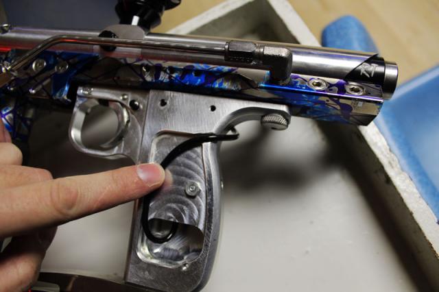

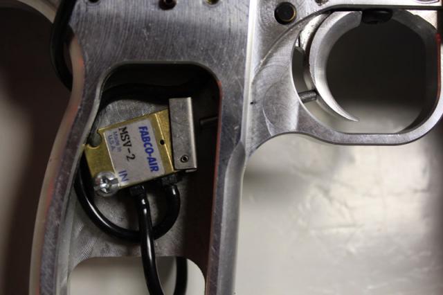

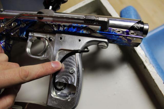

            They are pretty darn close to ready. The "sear housing" portion of the frame is sized perfectly to fit the ram. The grip panel mount holes are well positioned to double as set screws for the ram, but I found in necessary to tap another one so the ram wouldn't come loose when you took the panels off. The broad flat panel on the inside gives you many options for mounting the switch. Very little modding needed.
            The pneu frame functions perfectly off the body but once mounted it sometimes requires a double pull to get the sear to release. I ran out of air while tuning it a few months ago so I probably wont be able to work on it again until after the thaw .
            PS- with the cut down level and trigger rod positioned where it is the pull is noticeably heavier than my other pneumag, but also much shorter. This setup seems to make more sense given that it's a single trigger.

                In regard to the double trigger pull, could your ram be sitting too close to the sear leg? I run into that issue with trigger stops if they're setup boarder line too tight.

                  I'm going to call that the most likely culprit. It's also sitting fully horizontally which gives it the effect of being closer to the arm as well.
