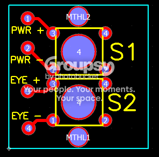

    For those of you that own one of my VER frames or a Logic EM Ripper frame that uses a UTB for the controller,... this is for you.
    I was going to build a replacement PCB for the VER frame that removed the slide switch in the back and replaced it with two push buttons.
    This would mean that the annoying act of sliding the switch up and down really quick to power the frame on (and the lack of an eye button), would be eliminated.
    Im certain I can get the Logic EM Ripper frame to take a power button, not sure if there is enough space for the eye button though.
    ** This would mean that you would have to de-solder and solder AT LEAST two wires from your existing setup in either frame. I will not provide a service for this. I will provide color coded diagrams to walk you though the process.
    ** There will be NO PRE-ORDER for this mod. I will first test it in both frames to get everything working in my guns, then if you want one, you buy one and I ship one **
    VER Owners - You would be getting a pre-made, pre-assembled PCB with two buttons on it
    EM Ripper Owners - You would be getting a pre-made, pre-assembled PCB with one (or two,... not sure yet) buttons, and an RGB LED on it
    PRICE - AT MY COST PLUS SHIPPING AND INSURANCE....... ALL PARTS, LABOR FOR PCB, MATERIALS, WILL BE POSTED PUBLICLY
    I will post pictures of the boards in the design phase later this weekend, and in a few weeks I will have the one ready for the VER to test.
    Im making a few for my own guns,.... figured you all may want one as well
    ** This is a "see if there is any interest thread". Once there is a completed in stock item for sale, I will make a new thread in the dealer section **
    Design Completed - 1/17/2014 - Prototype Cost = $83.93 shipped plus cost of buttons I already have

      UPDATE
      Finished the design - added to first post
      Cost to prototype board only = $83

          • p8ntbal4me
            No more UTBs!
            • Aug 2003
            • 2560
            The setup on all UTBs in the software is for push button.
            There is a difference in the software programing on the end user side because based on installation, there is one less button. (hence 1-button and 2-button UTB)
            Circuit wise, they are exactly the same (1 and 2 button UTB),.... which is why on the VER frame, its a nuisance.
            This will work with the 2-button UTBs and the 1-button UTBs.
            The only difference is how you would still program your board based on what version of the UTB you have installed:
            Example for the VER owners (frame came with a 1 button UTB installed):
            Turn the frame on:
            The way you have to now = slide the power switch up and down quickly.
            With the new two button board installed = push the top button once
            Changing a fire mode:
            The way you have to now = Hold the trigger back, slide the power switch up and down quickly, release the trigger
            With the new two button board installed = Hold the trigger back, push the top button once, release the trigger
            Changing a Setting:
            The way you have to now = slide the power switch up and leave it there until the LED blinks single red pulse, slide switch down
            With the new two button board installed = Push and hold the top button once until the LED blinks single red pulse, release button
            *** changing the value of a setting still works with the trigger as in all UTB versions **
            Accepting a Setting:
            If you own a VER Frame,.. you already know why this is a must have over the slide switch that the frame came with
            Here is the better part of what this mod allows you to do: you can change out the 1-button UTB with a 2-button UTB and it will work without being re-flashed with new software. Because this added PCB comes with an eye button, you already have everything you need
            ALSO: you could have your 1-button UTB re-flashed to use the 2-button software.....
            THIS WILL NOT WORK WITH A MORLOCK

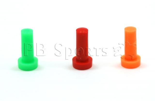

                        The raised button extension found on guns like the AGD E-Mag and WDP Angel iR3 are going to be needed for this application:
                        I dont want to buy a little plastic piece at 1.50 per unit,... rather buy a bulk bag and save some cash here.
                        Anyone want to help with this,... please feel free!
