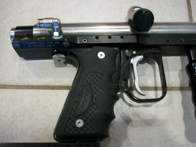

    OK, let's get one thing straight, I do not reside in my parents basement. I played for the first time this weekend due to a X-mas gift to my step-son. To say the least, we had a lot of fun. Not knowing anything about paintball markers, I bought him a Gryphon package from Dick's. It was more than adequate for him, the problem was with my rental. After a LITTLE research I ended up buying this off ebay.
    You all being the experts, what do I need to do to make this a reliable, fire and forget marker that I do not need to fuss with.
    Any information would be appreciated.
    RT AUTOMAG
    by arigun designs
    Recommended input is 600-800 psi

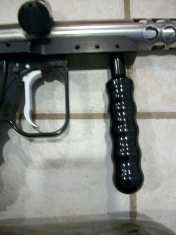

    black metal front handle and grip in excellent condition with dye grips
    custom products barrel about 10 inches long

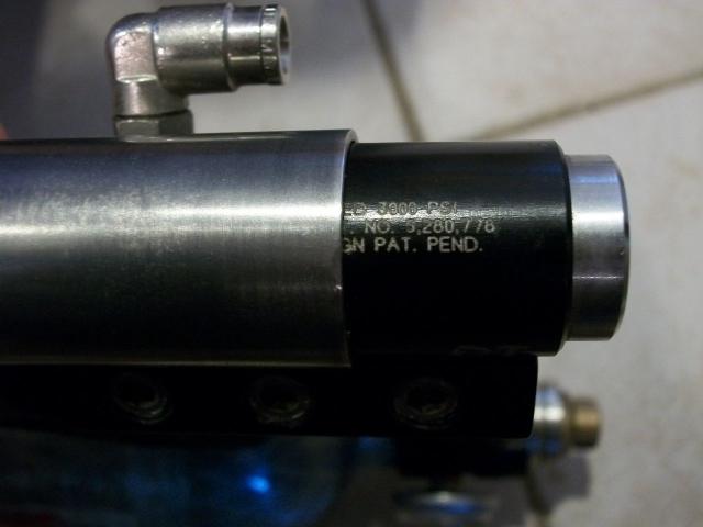

    above the frame on the back slide says rt04104 and 3000 psi
    Trigger guard says AGD
    Gun says*Compressed air*or Nitrogen only

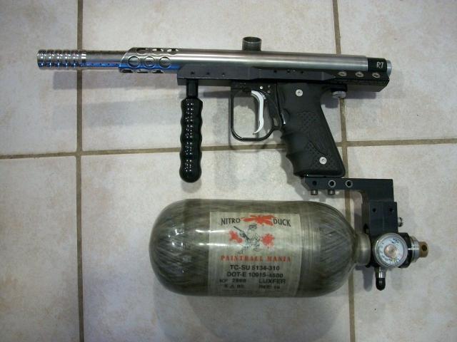

    NITRO DUCK TANK
    brass end spins easily(i assume that is to adjust the regulaor)
    one gauge says 0-5000 psi and use no oil
    other gauge says 0-1200 psi and use no oil also this gauge says 300 psi in the tank
    says made in usa and sn 024272
    luxfer number p11a-1
    tc-su 5134-310
    month 11 year 06
    DOT-E 10915-4500
    KF 2899 LUXFER,

      You will probably need to get that tank hydro tested. If there's a SCUBA shop near you, they can tell you if there is a local place that does hydro testing. Otherwise, Ninja Paintball does it. That's who I linked. Once that's done, get some macroline connected from the fitting on the rail to the tank and air it up. I would start with the pressure adjusted so the 0-1200 gauge reads ~850. Let us know what the marker does from there. We should be able to help fix any problems you may be experiencing with it.

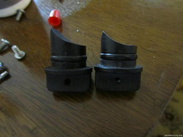

        First easy thing, you need a feed plug like the one on the left, not like the one on the right...
        The flat spot on the right one can cause chopping.

        Ducks are a bit old and getting thin on support. Your tank is also out of hydro-test (every 5 years). If you have a local test facility, you might want to just get it tested (~$30) and see if it will motor-on. Otherwise, you can always send it in to Ninja for test and trade out of the regulator for a high pressure output reg ($90?). That would mean an ASA, and maybe a drop also (another $30-$50). So, yeah, the tank is a slight weak spot.
