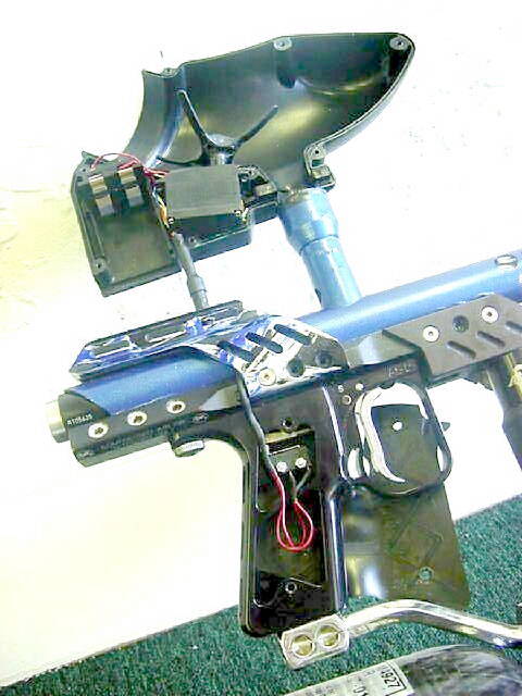

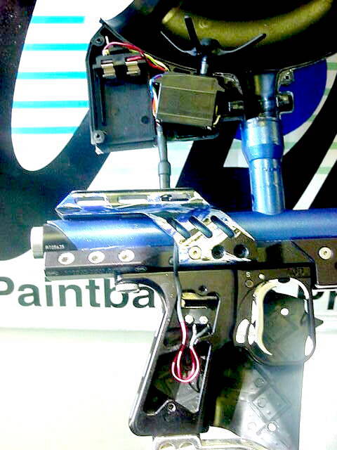

    Guys,
    Brian wanted me to post these pics showing how he ran the wires to the Rev from the Intelliframe.
    FYI
    AGD

              re connection?
              what did you use to hook that up?
              Paintball is the most addictive, expensive sport there is...besides smoking crack!
              • BONESisAgod
                hell if i know
                well, now that i have the gun, i can give you a little insight, but if you want to know everythin ask brian himself. Its a 3 prong male plug (from hopper) to a 3 prong female plus (to sight rail). The sight rail is milled so the female plug can pop up. The line from the grip connects to the sight rail. The only 2 flaws I have found with the intelefeed is you have to tape your feedneck to high hell to get it to stay still (VL's fault) and sometimes during slow fire the paddle doesnt turn enough to kick a ball into the neck (usually only with full hoppers). Other than that I love it. BUT, i think i may go with warp feed or VL X board when I get a X-treme body.

                    the RC car industry has some realy small plugs that would work good for this sort of thing, I may even have some in my old pit box.......
                    "if I over shoot you, will you respect me in the morning?"
                    • BONESisAgod
                      ill take pics of my intelefeed and post some pics either tomorrow or monday. That should answer any questions.
