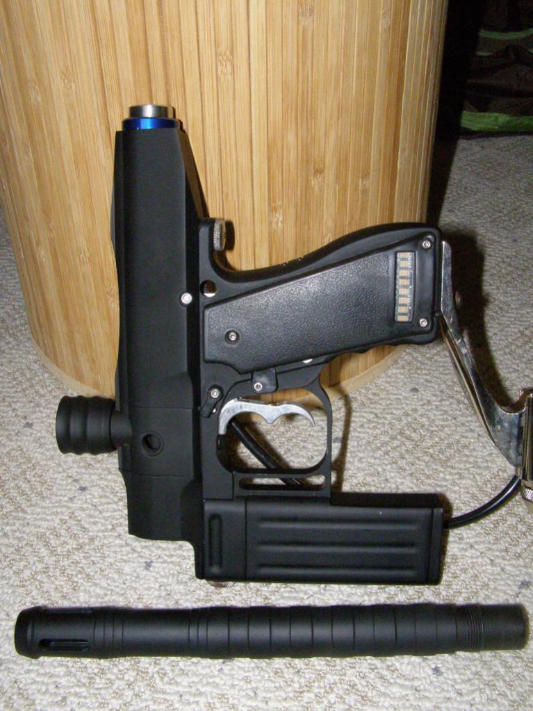

                  I use a valve like this one in this xmag
                  • Frizzle Fry
                    AO Micromag Guy
                    • 3280
                    Originally posted by knownothingmags View Post
                    [ATTACH=CONFIG]89085[/ATTACH]
                    Dammit Cougar - It's like marrying a Victorias Secret model, then making her wear a burqa in public.
                      lol
