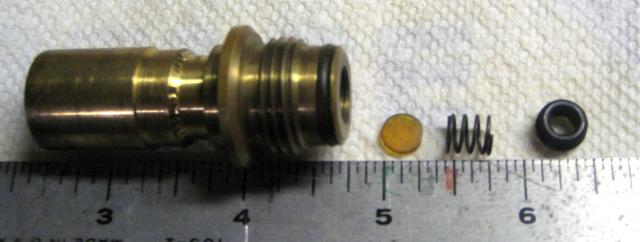

      While organizing my parts bin and putting stuff away I found what appears to be a match to the oring in the check system. I believe the CCI bucket changer pierce pin seal is a match or at least a close match. I haven't had any luck with matching the spring but will keep looking.

        I was informed by Slim on MCB that my setup is actually a custom one off that was in one of his Micro CA2s. It works very reliably for me so if you want to try an alternative to the original it is something to look into.
        He did also send me this pic of the stock check valve.
          of course i was super slammed in the shop today and didn't get a chance to cut up one of those screws. still not sure if i want to go with the pin spring method or go with the ball bearing like you did.
          note: classic reg piston, screw,spring,seal do not fit. seal could be cut down but spring and screw are the wrong size.

            I'll send you a CCI pierce pin seal as well if you want to try something similar to my setup. Then you can find a soft spring and a bearing.
              #21
              we have a bunch at the local shop they are cci dealer. im looking at pricing some bearings and screws and all.
              didnt look very cost effective to try and order any bulk springs,bearings,etc.
                #22
                went ahead and ordered 5/16" ball bearings 100 count as well as 25 count 3/8"- 24 x 3/16"
                now to find springs.
