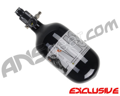

                              ANSgear is the worlds largest online paintball store. Huge selection of Paintball Guns, Tanks, Masks, Loaders, Harnesses, Barrels and more. Fast & Free shipping will keep you up to date with all of the best paintball gear.
                              ANS Gear has some stock 68/4500 tanks for sub $100. Yank the reg they give you and drop your Ninja on it. Pretty good price.
