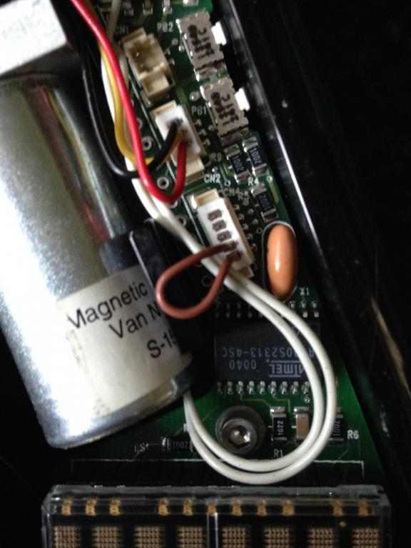

      I would like to see an close up picture of the jumper please
        this is the part.

              I'm guessing it's the little brown loop in the center of the frame?

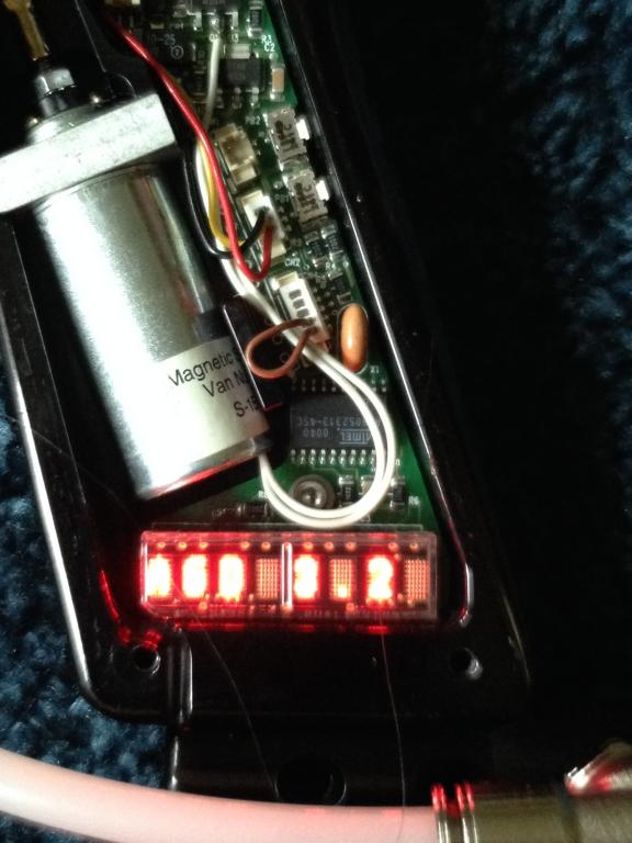

                Sorry for the low resolution but the red pixels are murder on the lens of my phone! Anyway it says AGD 3.2Click image for larger version

                  Hey guys, thanks for the quick response! I posted some pix of the internals and I hope you can see them..
                    yes, that is the jumper.

                        I don't think there are burst modes on version 3.2. It is only available on 1.37.
                        Version 3.2 does have shot buffering which makes it faster in semi mode than version 1.37.

                          So there is no use for jumper if you have 3.2 mode?

                            I don't think the jumper does anything in version 3.2. It does have the jumper used as a tournament lock on version 4.2.

                              Ok, so my Xmag 3.2 doesn't have burst mode enabled. But it does have a code that reads "SHBF 6" which can be increased by increments of 2 all the way up to 100 then it resets back to 4. I'm guessing a higher setting equals a faster semi-auto cycle rate?
