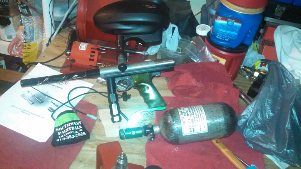

                    Jwinter,
                    Welcome to the forums!
                    Might I suggest posting a picture of your mag in this thread so we can break it down for you and let you know which parts you have, and what to substitute them for in the case that you're looking for a higher rate of fire.
                    Naturally, for a faster shooting mag, you'd want to upgrade to a X-valve, and then get your hands on a Ninja SHP Tank.
                    That's just for starters, but with those parts and your bouncy trigger, you'll already be pushing over 20bps.

                          ULE body, X valve with RT on/off with a ninja shp regulator at 950 or higher. the grip frame is a personal choice as if the gas thru front, both can be changed for a better personal fit if you want you won't find a lighter frame though. you can probably sell the splash ano barrel pretty easily.
