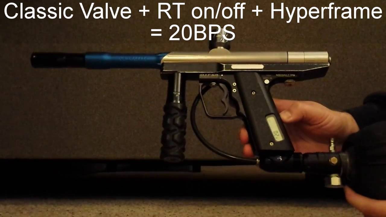

I had a few parts laying around that needed to be put into action...
And the "Hawaiian Hyper" was born:
But the questions everyone wants to know is if she works... You tell me:
First Mode was 5BPS burst mode at a 20BPS set. The next mode was semi at 20BPS, but because of the stiff micro switch it's still too hard to walk. The last mode was full auto 20BPS. The reason it stopped working was because a spacer I had behind the noid had slipped out. I replaced it with a better option and she was back up and running.
