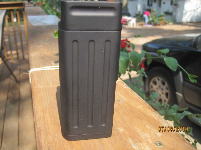

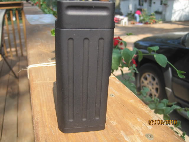

      I like this idea. Would also like to see the angle on the lower front of the grip rounded out a bit.
      Lastly, I think it needs a little more character, would love to see some side milling similar to the PTP battery packs.

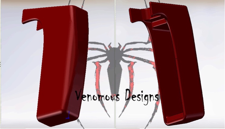

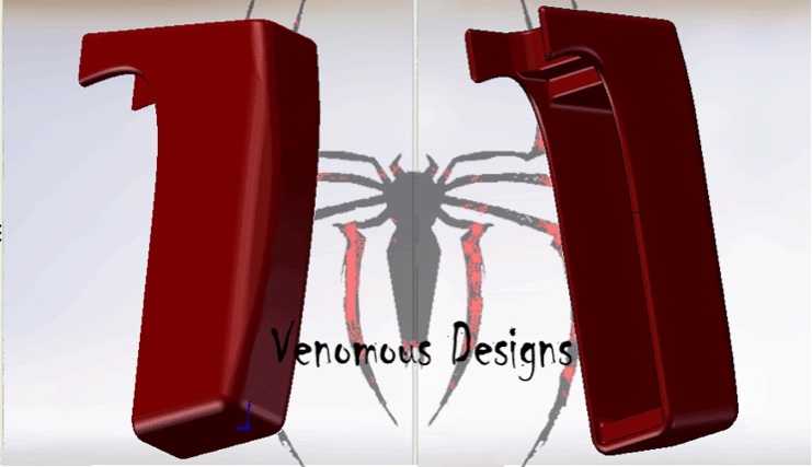

          There is a venomous designs one that was kinda my initial inspiration. It was open and looked like it could slide over the grip frame.

                        But what I think he was referring to is something similar to the way the venomous one is. Hollow, open at the top and wider than a trigger frame. Maybe so that it could be a slight bit wider (deeper/front to back) in general... That would give it the option of filling the top gap between the trigger frame and the front grip on an RT rail, but also allowing it to fit on an AM rail by just overlapping the trigger frame.
