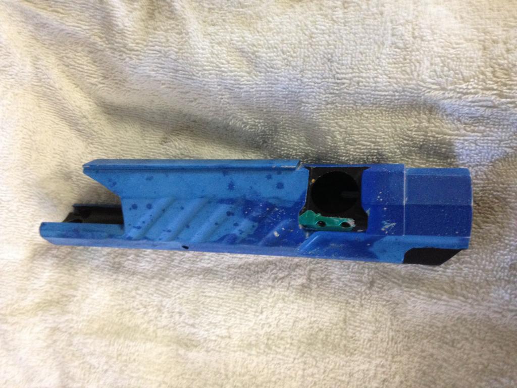

    Thanks to fstop's amazing CL search algorithm (or whatever NSA-level system he uses), I was able to pick up a MicroMag yesterday for about $50. See the original post in Automag Finds if you want more details on the acquisition.

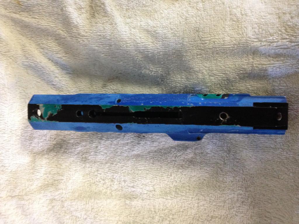

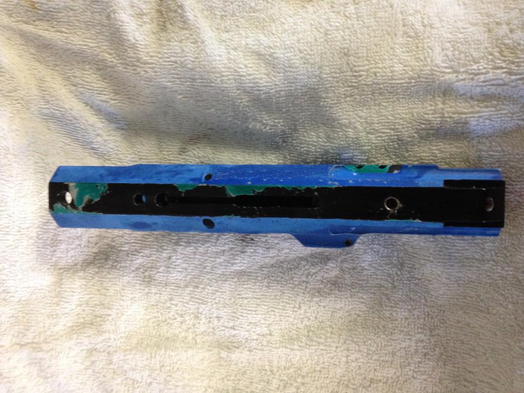

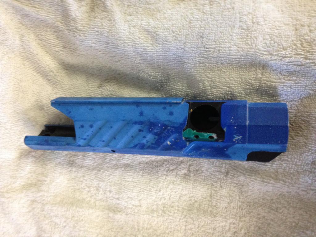

    This thing was a beast. It had a "custom" two finger trigger (a long machine screw tapped into the base of a single trigger) and custom grip plates made of clear plexiglass. It also had a "custom" finish, which appears to be some kind of semi-hardened black matte material (maybe a really bad powdercoat, or textured metal spray paint) on all the parts, which was then painted over with blue paint on the body itself. When I took it apart, I noticed that some parts (i.e. the face of the body where the rail mounts) were annodized satin black with these bizarre teal/light blue smears every so often. See pictures:

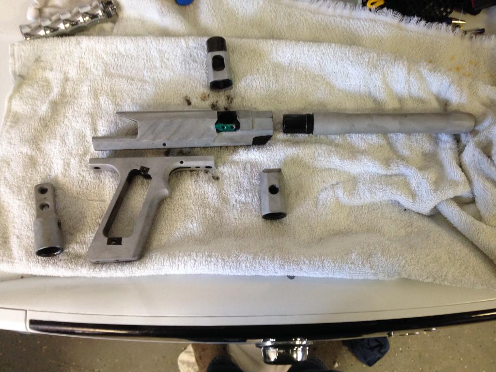

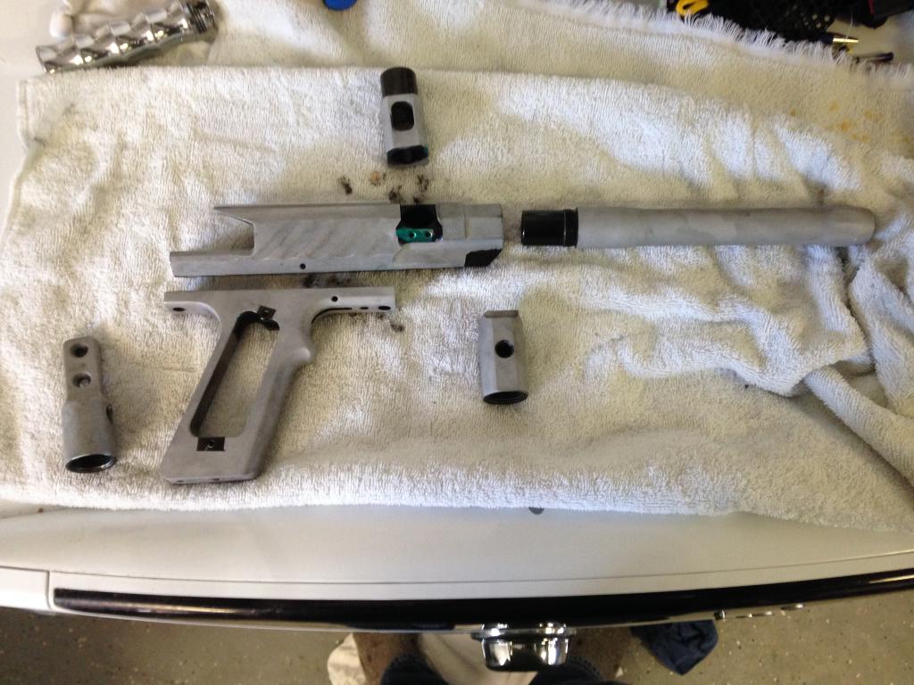

    So I stopped by the hardware store this afternoon after dropping the lady off, and grabbed some Stripeeze (sounds like a shady place on the side of a highway) semi-paste paint stripper, gloves and a scrubbing brush. I gently massaged each piece after full disassembly, and the result is below:
    You can still see some spots where the underlying anno remained.

    - I think this is a Gen 4 micromag (judging by the taper over the top of the valve), but can anyone confirm?
    - Any thoughts on what the black was? I think it had to be paint with how easy it came off.
    - Did this edition of micromag ship with the benchy frame with no trigger guard?
    Update: Thanks to Tuna, I've talked to Forest at PTP. He says it was originally "Wild Tiger." The green faded a lot on the exposed parts to more of a teal blue, but he seems pretty sure of it.

        wow, so the paint stripper removed the anodizing??
            Yeah, but only where the paint was over the anodizing. I can't really explain it myself, but I have zero experience. The anodizing that wasn't painted over (see in the powerfeed dovetail and along the bottom of the body, as well as where the grip screws go in) were totally fine.
