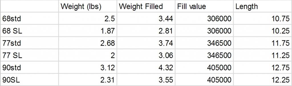

          Does anybody have the actual lengths of the SL tanks. I can't seem to find how long a 45/4500 SL is anywhere. I remember seeing a picture comparing normal tanks to the SL tanks but can't find it and don't remember if the 45/4500 was on there.
              Hmmm. Yah that was posted here at one time. I've compared my tank with the newer 68sl. I love the shorter tank. But 68 or 77 will be my shopping. Just a matter of what I can find.

                I looked more and found these, unfortunately the 45/4500 isn't listed
                    i have exact weights and sizes of the old 68, 68 sl and 77 sl. i actually need to make a video comparing them all...i'll probably do that this weekend. the 45 will likely not be included in any old comparison, as that size tank *just* came out.
                    here are my notes of the 68 and 68 sl (old 68 standard reg had a steel bonnet, and is 1/4" shorter than the pro v2 reg):
                    Ninja SL 68/4500 w/ pro v2 reg:
                    1 lb 15.2 oz; 10 1/2" long; 13 3/4" diameter
                    Ninja 68/4500 w/ standard reg:
                    2 lb 6.4 oz; 10 5/8" long; 13 3/4" diameter

                          Unless I'm mistaken the new 45 45 is the same length as the 68. Much smaller width.
                            it certainly looks that way to me...or maybe like 1/4" shorter, at most. here is a pic of all the ninja sl tanks over on the 'nation.
